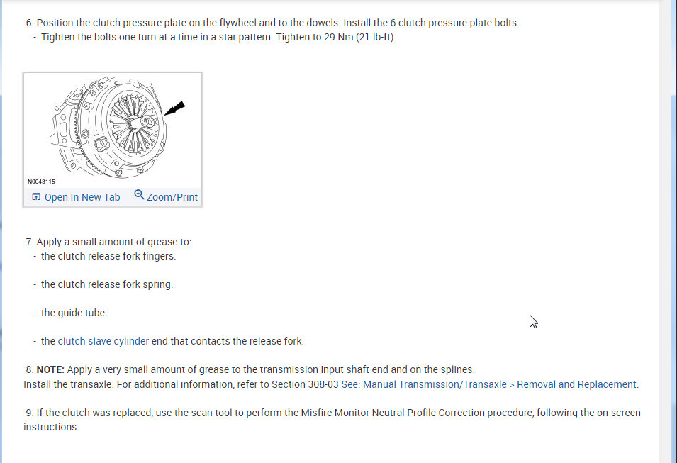

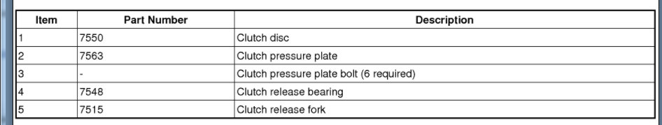

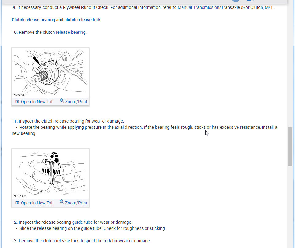

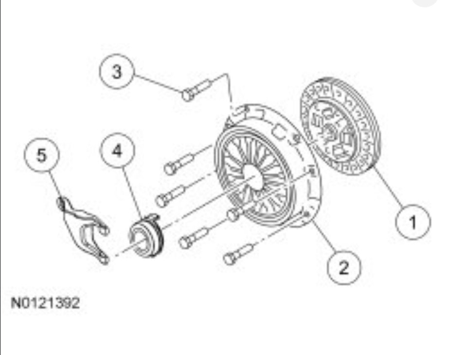

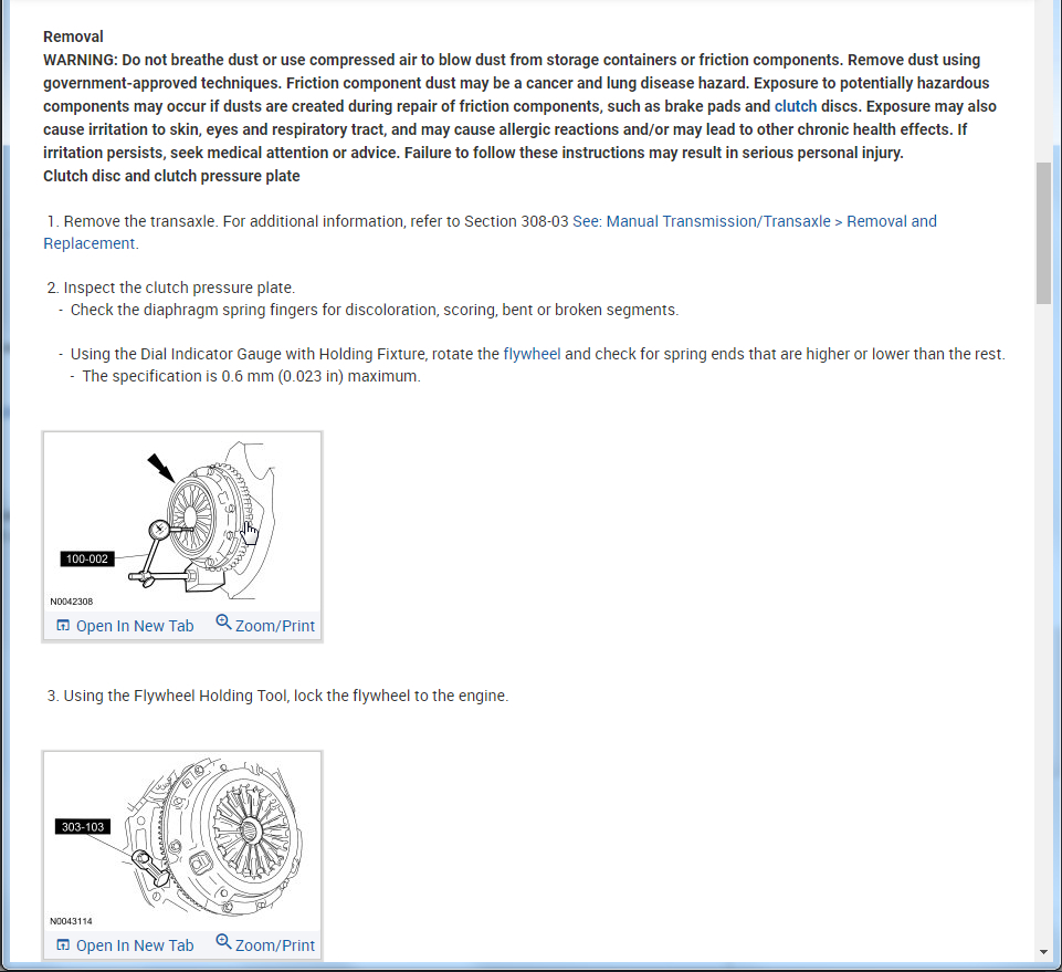

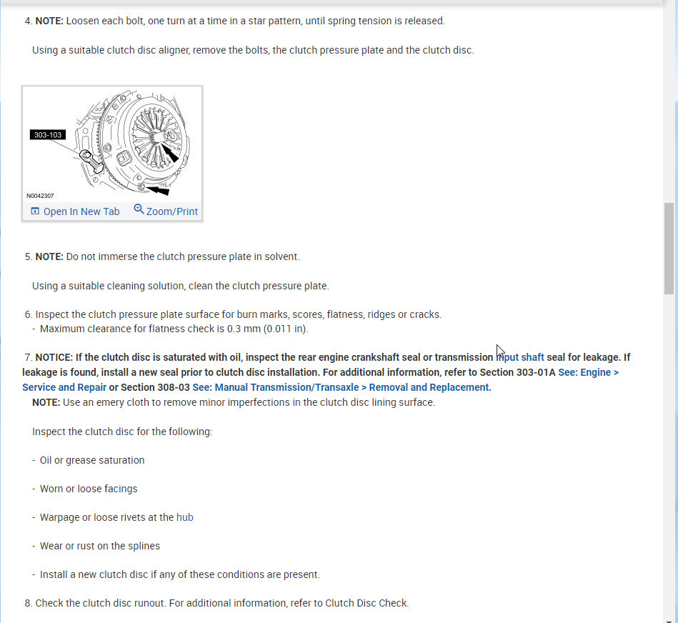

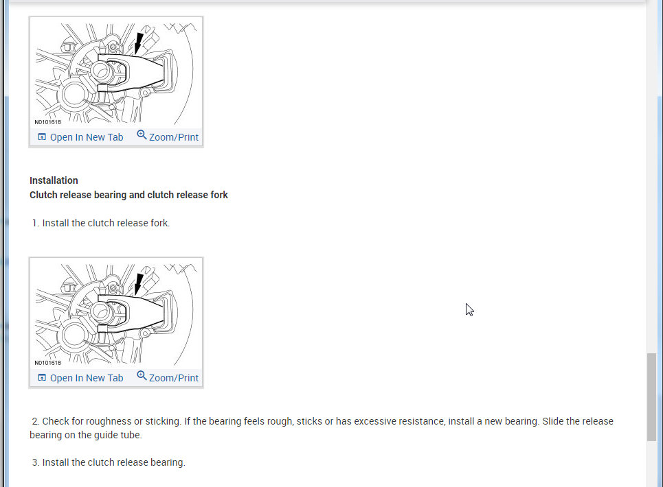

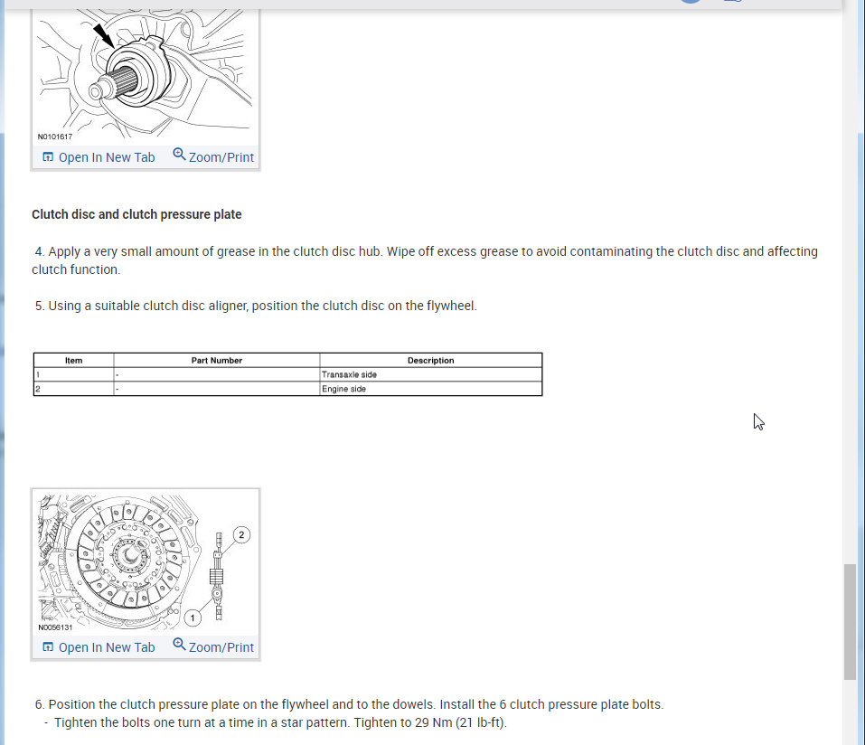

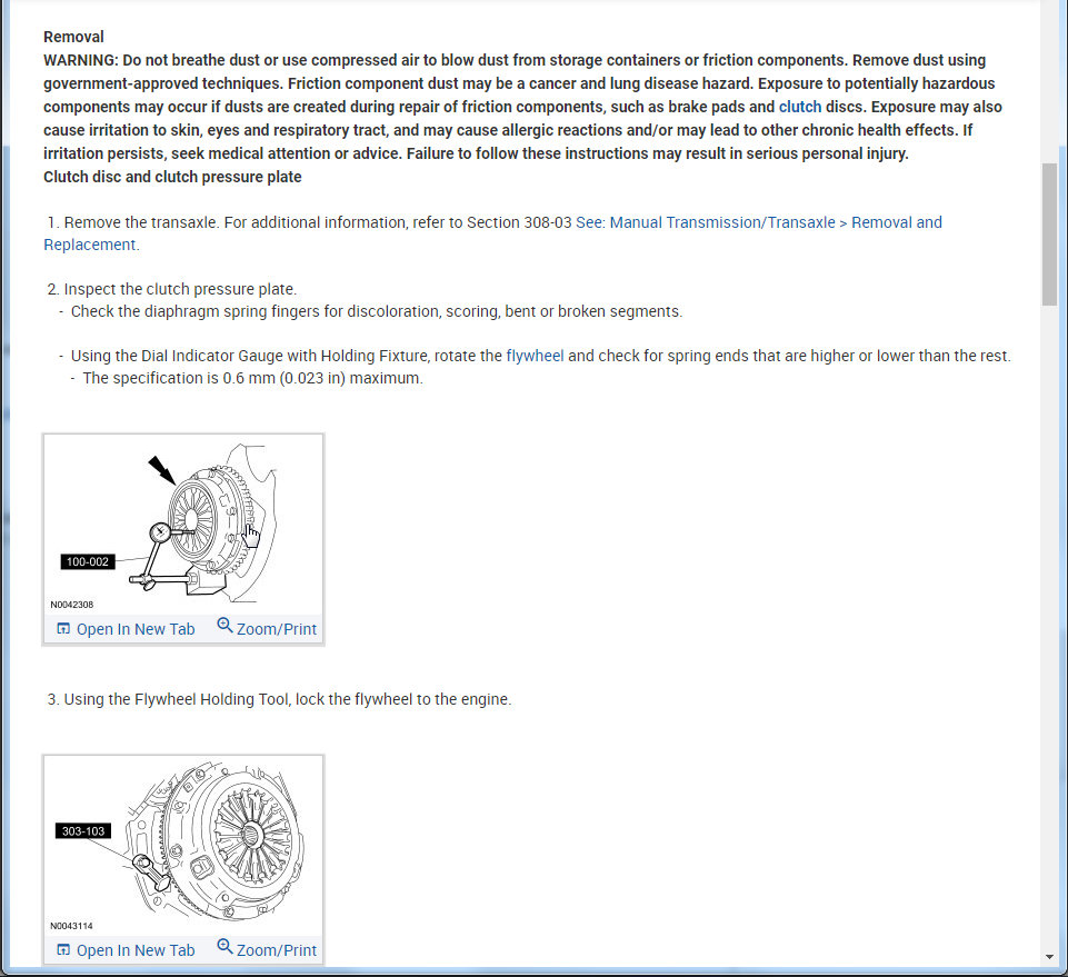

How to replace the fork and throwout bearing?
Feb 25, 2021 at 10:34 PM
They don't list this process specifically for these parts so we need to use the process for the disc and pressure plate that includes these parts.
Here are a couple guides that will help as well:
https://www.2carpros.com/articles/how-to-replace-a-clutch
https://www.2carpros.com/articles/throw-out-bearing-replacement
Let us know if you have questions. Thanks
