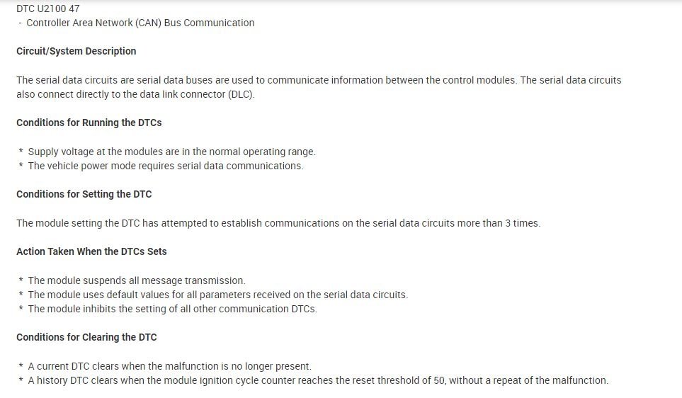

Transmission defaults to low gear, after I reset the DTC with scanner it goes back to normal. Symptoms return at random times while driving! Sometimes immediately and sometimes maybe a day or 2 later?
Apr 1, 2021 at 7:29 AM
Good morning,

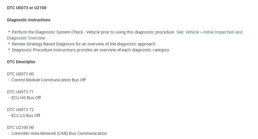

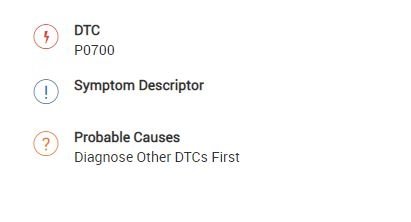

The 700 code is an information code that tells you there are other codes related to the transmission.

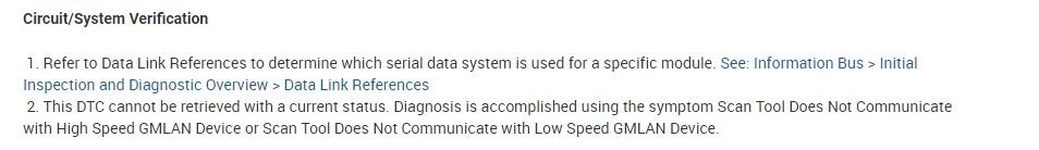

The 73 code is a communication code for the serial data line. Apparently, the Transmission is not communicating on the data line.
I attached below the description and the flow chart for the 73 code.
