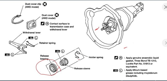

Is middle of the throw out bearing one piece or does the center metal shaft come out in order to replace the hearing itself?
Jan 17, 2020 at 4:07 AM
Good evening,

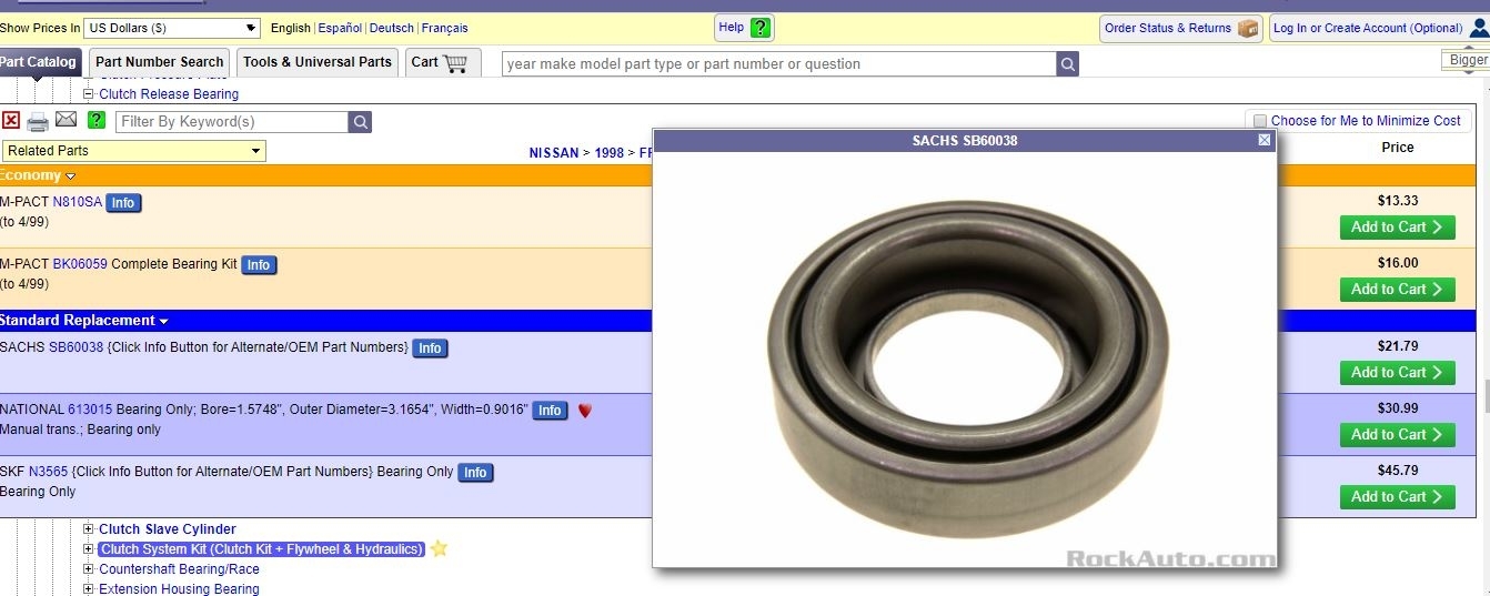

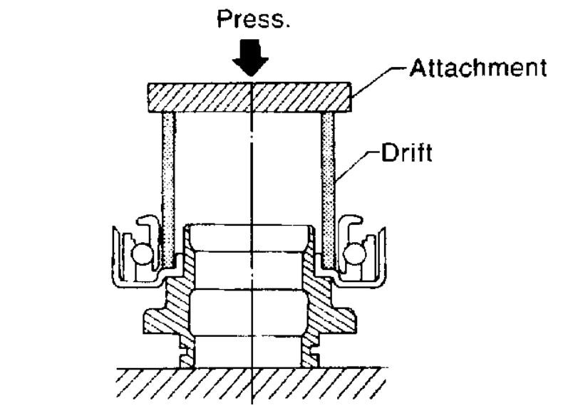

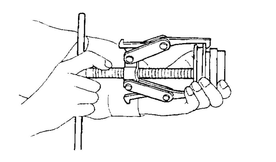

The throw-out bearing slides off the collar on the front of the transmission. There is not center shaft.
I believe you think the input shaft into the transmission is part of the bearing and it is not.
I attached some pictures for you.
Are you trying to replace this?
What is the issue?
Jan 17, 2020 at 7:39 AM
The throw-out bearing slides off the collar on the front of the transmission. There is not center shaft.I believe you think the input shaft into the transmission is part of the bearing and it is not.I attached some pictures for you.My Admin just informed me the pictures did not come through. Check out the diagrams (Below). Please let us know if you need anything else to get the problem fixed.
