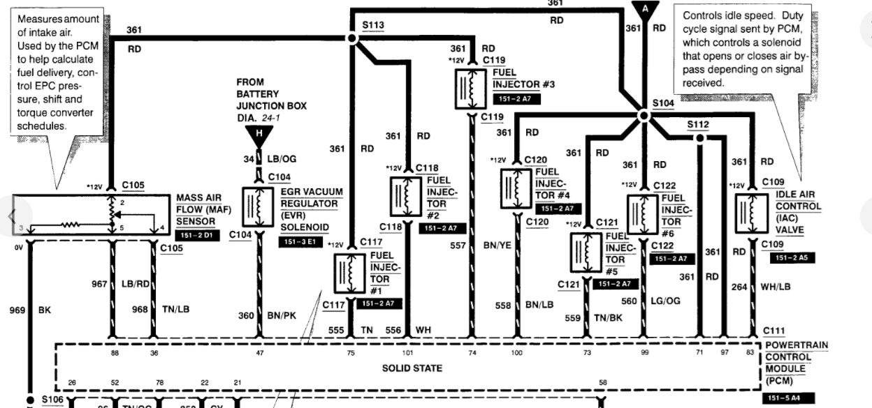

I am not getting power to the throttle valve control.

The red wire to the IAC is a common voltage sent to all the injectors as well. It comes from the fuse block.
Does the engine run?
Did you check for power with key on engine off?

Okay, the red wire should have power and it comes from a splice that also feeds the injectors. It is the same color wire. Check for power to the injectors on the red wire.

No, you need power before you can think a ground.

As I just stated, check for power to the injectors.

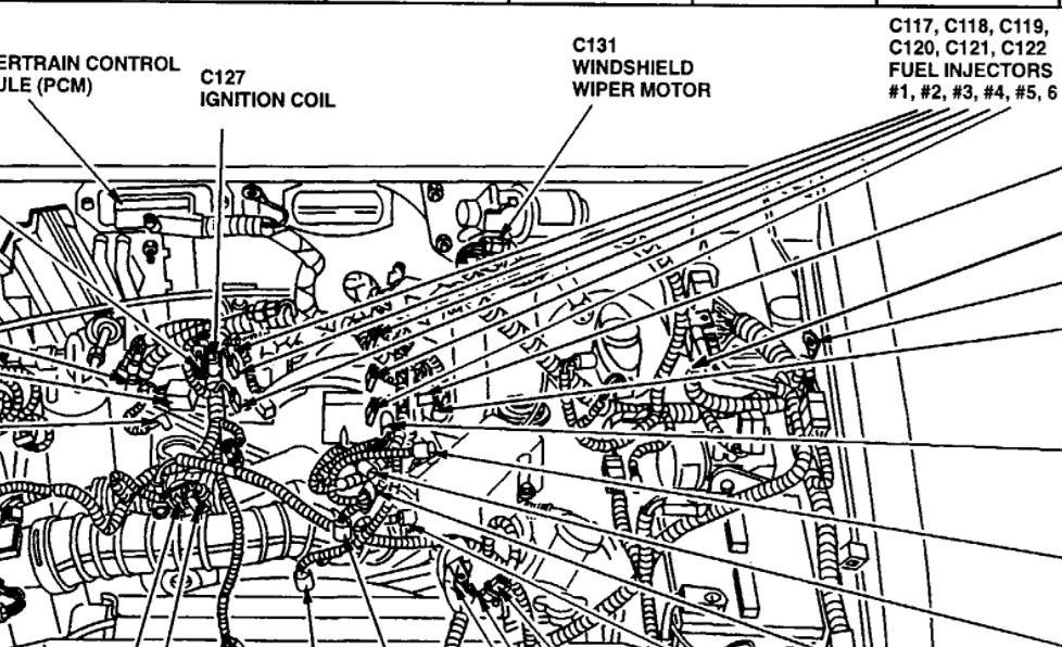

It goes to a splice that ties the injectors as well. Let me see if I can find the splice.

The splice is back by number six injector harness. C122 is the connector.

So I will need to take the intake manifold off to get to it.

The diagram you sent is too small to read. I am using my phone to communicate do not have home internet thanks anyways.

You can run a jumper wire from the red wire from the injector to the red wire of the IAC and see if it makes the valve work.
