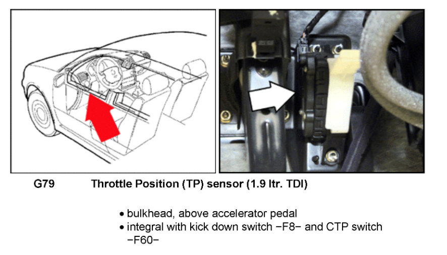

Hi, upon scanning P0122 and P0222 came up and list throttle position sensor as the fix. Could you tell me the location of it in the throttle body? Thanks
Sep 18, 2020 at 10:24 PM
Unfortunately we don't have the 1.8L in the USA so I am not positive on its location but I am confident that it is in the same location of the 1.9L. That would be on the accelerator pedal as shown on the attachment.
Let me know if you are still not able to find it and we can try to find some more info.
