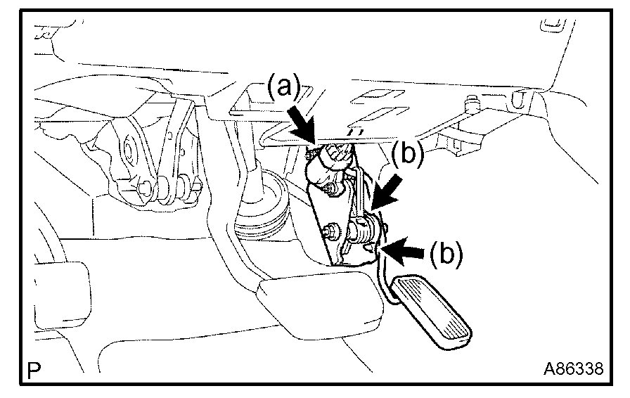

We have replaced the TPS which is on the accelerator pedal in this car and it is driving in limp mode now. I've read that it needs to be adjusted but I can't find any information on how to adjust it for this car specifically. Thank you so much for your help!

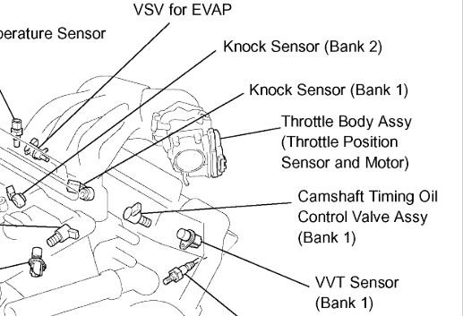

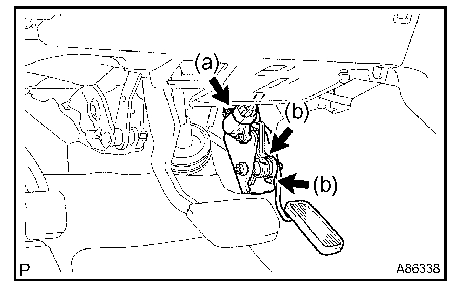

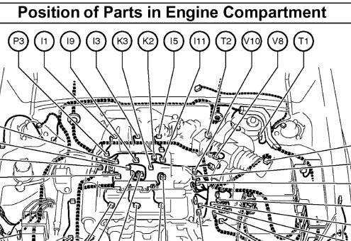

Can you tell me the trouble code you are getting? You mention two different things. First, you said you replaced the throttle position sensor on the gas pedal. That is the accelerator pedal position sensor. The actual throttle position sensor in under the hood on the throttle body. See pictures 1 and 2. Item T2 is the throttle position sensor in picture 2. Now, there is no adjustment for the accelerator position sensor. I am going to provide the directions specific to that sensor so you can review them and confirm you did it correctly. Picture 3 correlate with these directions.

Accelerator pedal sensor
2004 Lexus ES 330 V6-3.3L (3MZ-FE)
Procedures
Vehicle Powertrain Management Fuel Delivery and Air Induction Sensors and Switches - Fuel Delivery and Air Induction Accelerator Pedal Position Sensor Service and Repair Procedures
PROCEDURES
ACCELERATOR PEDAL ASSY (3MZ-FE (NORMAL PEDAL))
REPLACEMENT
1. DISCONNECT ENGINE WIRE NO.3 (BATTERY NEGATIVE TERMINAL)
See Picture 3
2. REMOVE ACCELERATOR PEDAL ASSY
(a)Disconnect the accelerator position sensor connector.
(b)Remove the 2 bolts, then remove the accelerator pedal rod.
3. INSTALL ACCELERATOR PEDAL ASSY
Torque: 5.4 N-m (55 kgf-cm, 48 in.-lbf)
4. CONNECT ENGINE WIRE NO.3 (BATTERY NEGATIVE TERMINAL)
5. SYSTEM INITIALIZATION
