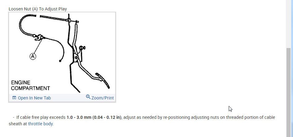

I haven't been able to solve this issue. Every morning and every time i go home i get in the car and the Throttle is stuck closed. I can push the gas pedal and it will pop out no problem, but what's going on? I thought it might be a dirty Throttle body but that thing was clean. I hardly removed any build-up. Any ideas would be much appreciated.
Jan 4, 2021 at 5:36 AM

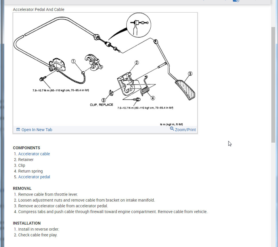

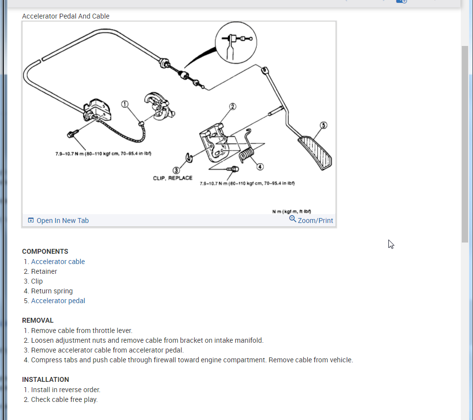

You are correct that this is either the throttle bore is dirty or the throttle cable is binding.
If you cleaned the bore and it is clean then I would replace the cable and retest.
Below is the process from the manual on how to replace and adjust it. Let us know what happens with this. Thanks
