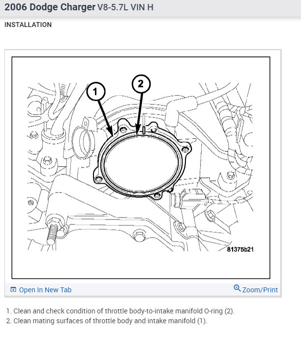

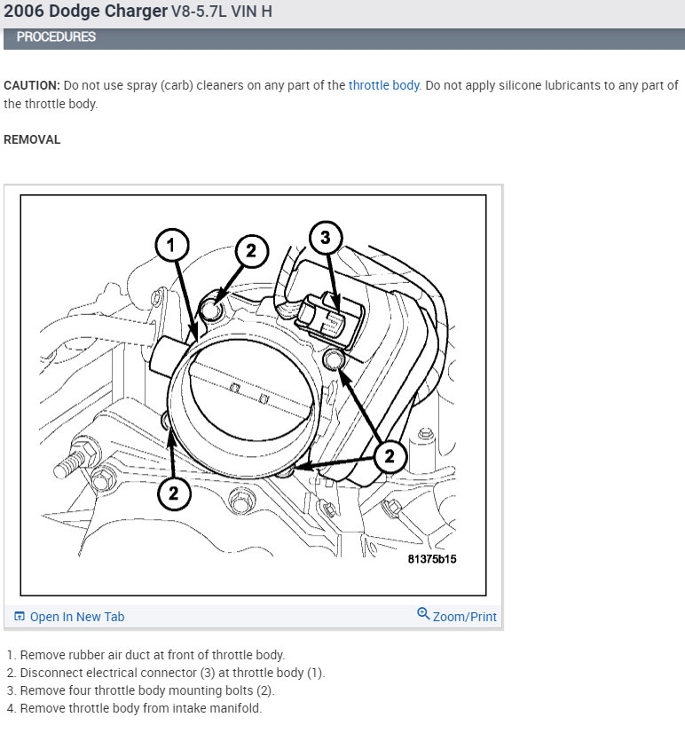

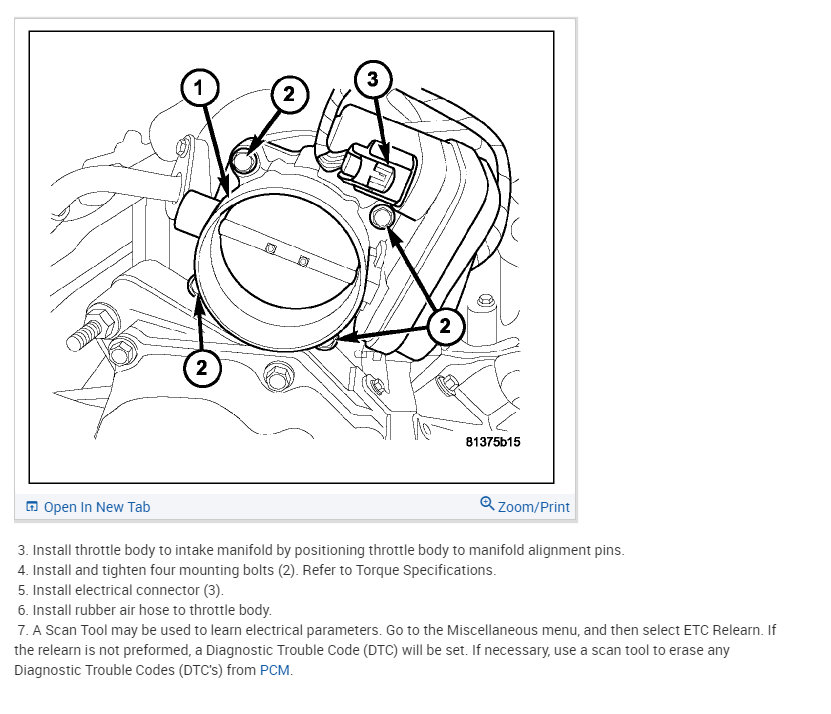

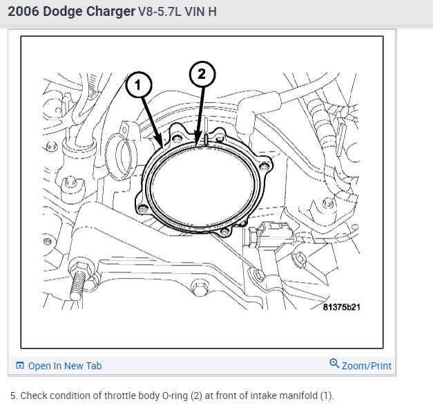

yes, the throttle position sensor in part of throttle body assembly. The pedal position sensor is under dash part of gas pedal I get no check engine light even when goes into limp mode. ran scanner also showing no code but if I turn ignition 3x's I get code 2122 on dash screen.
Jun 17, 2022 at 6:43 AM
SQM
  • 6,383 POSTS
One of the most common causes for limp mode is having a dirty throttle actuator.
Dirty actuator will not bel able to provide correct data to the ECM and that can trigger the limp mode.
Take a look at this helpful guide:
https://www.2carpros.com/articles/reduced-power-limp-mode
