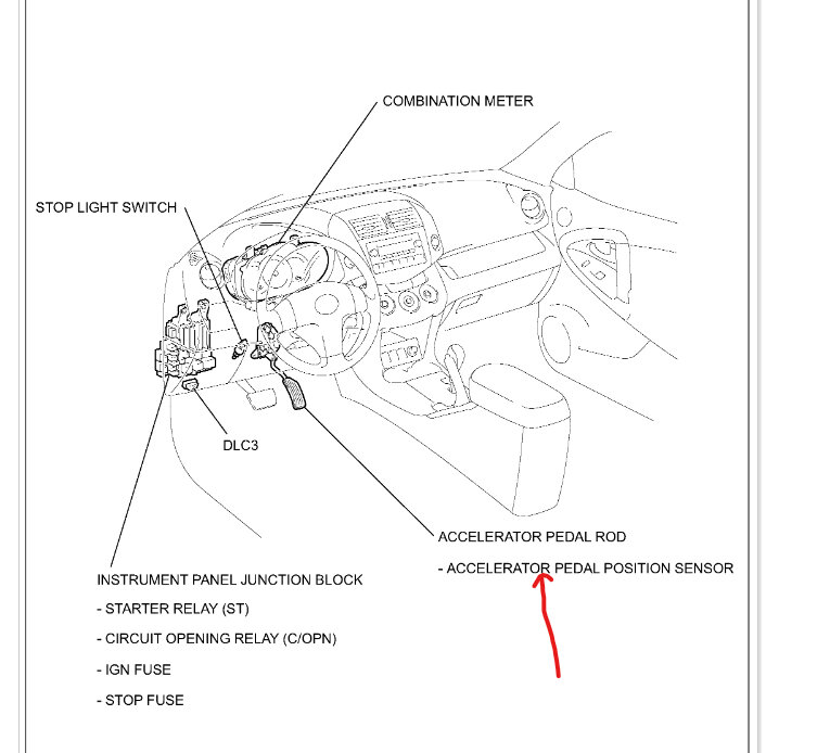

Changed throttle body but still not going past 2,000 RPMs. now I got fuel rail pressure high input.

Can we run the codes to see what comes up?
Here is a guide to help:
It sounds like the throttle pedal position sensor went out here is the location so you can check it out. Check out the images (below). Please let us know what you find.
