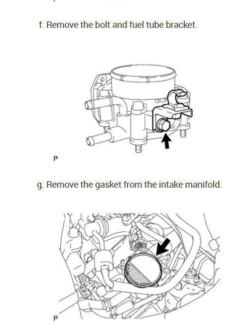

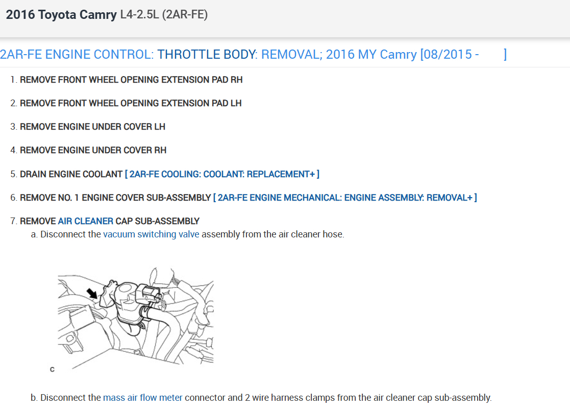

The car's owners asked us to raise idle speed. He said it's too low. We connected scan tool and did throttle resetting learn but the engine stalled at idle. Please, if I missed or correct procedure help me. Thanks
Feb 4, 2025 at 12:43 AM
  • 55,433 POSTS

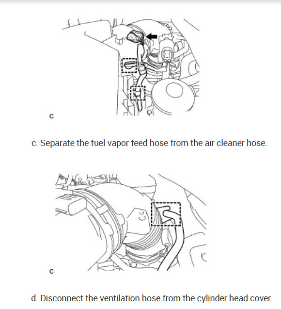

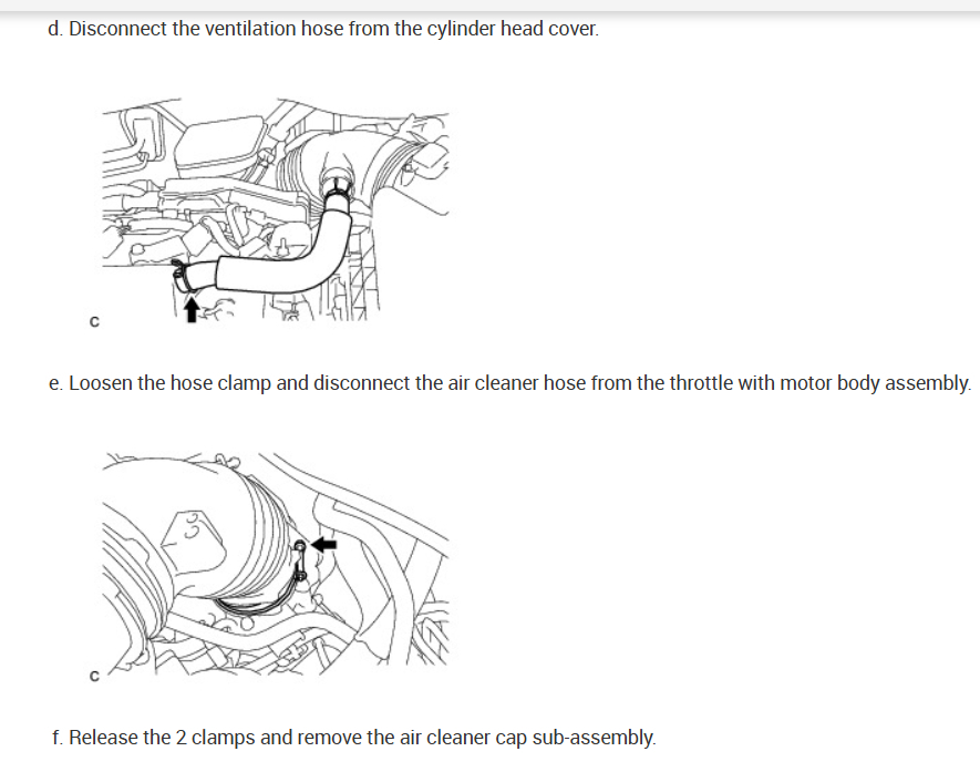

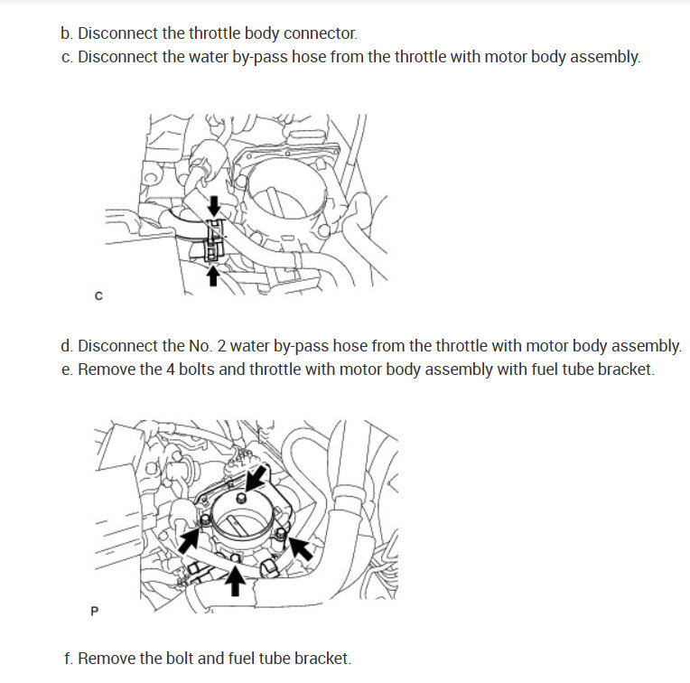

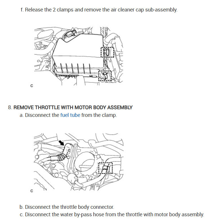

I would service the throttle body and look for vacuum leaks. The computer sets the idle sped and it cannot be adjusted. Let's go over this guide to help fix the problem:
https://www.2carpros.com/articles/low-engine-idle
and this guide as well, I included instructions for your car in the images below.
