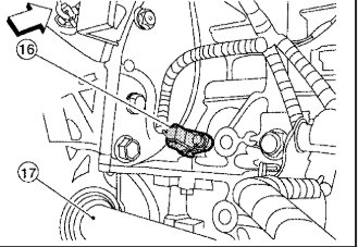

Do you have any codes? This would help us, also a weak signal from the crankshaft sensor which will not cause a code, it will just make the engine hesitate and stall. Also, a bad MAF sensor can cause this without codes as well. Here is a guide to help us see what causes hesitations.
https://www.2carpros.com/articles/engine-hesitates
We need more information to help you fix the problem. You can unplug the MAF sensor to see if the problem goes away, also here is the location of the crankshaft sensor. Check out the images (below). Please let us know what happens.
