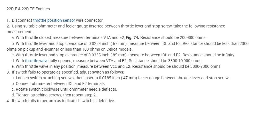

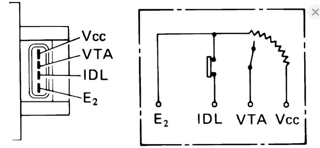

What is the trick to unplug the connector to test the TPS? I tried pulling on it but no go.
May 10, 2020 at 3:11 PM
Experienced Mechanic
52,796 POSTS
Good morning,
There should be a clip on the connector. That clip you will need a small pocket screwdriver to lift the clip up to release it from the sensor.
If you do not have that, please post a picture so I can see what you see.

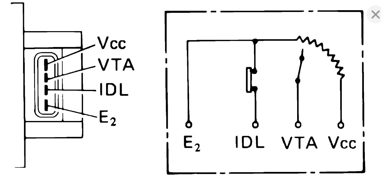

I posted below the adjustment procedure for you as well as the pin out for the connector.
