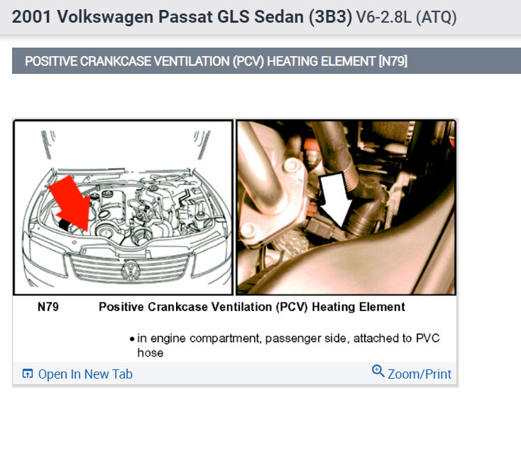

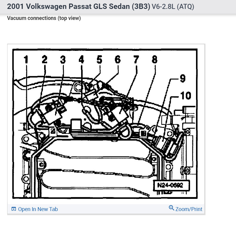

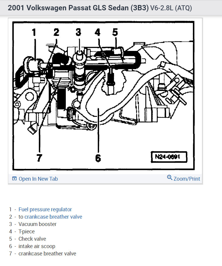

My friend didn't mark any hoses when he pulled throttle body. He disconnected all four vacuum and coolant hoses from both ends. Can't seem to find hose diagrams that actually show the throttle body ports, and where the hoses go from each port. I could also use a PCV hose and valve diagram. This is a 2001s Passat 2.8L V6 4-Motion.

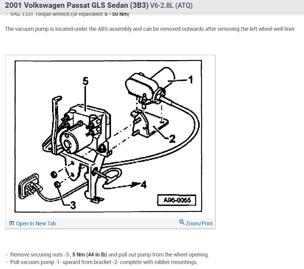

That is good to hear! I found the vacuum diagrams you have requested which I have included in the images below. Please upload pictures of the problem or if you have any questions.
