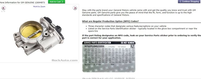

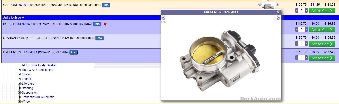

I'm confused. I have two codes p)122 and p0223. Rockauto lists a throttle body actuator connector that plugs into the throttle body, but they also list a separate 3 wire throttle position cable sensor connector.
I can't find where the 3 wire connector would be. Rockauto customer service wouldn't help.
Do you show a separate throttle body actuator connector and a different throttle body sensor connector? If so where can I find the 3 wire one on the car?

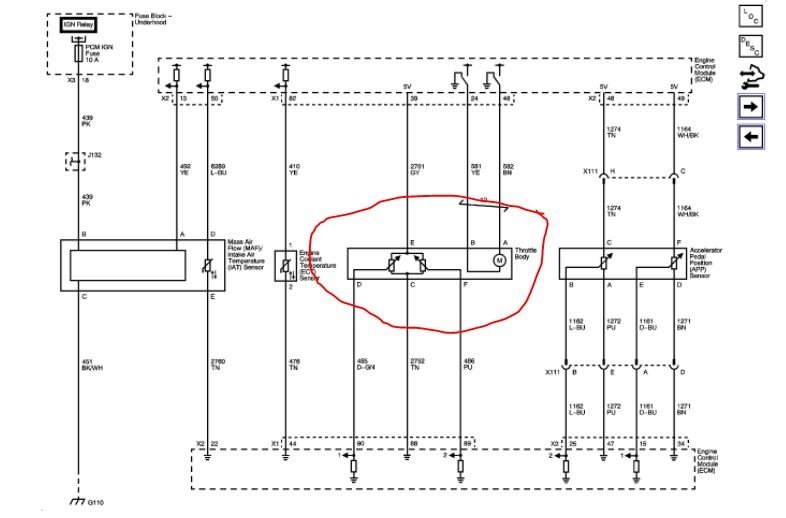

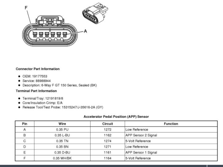

Rockauto does not have the correct connector. The connector at the throttle body is a 6 wire connector as it controls an electric motor inside the throttle body. I would check the connector for any damages, loose or corroded connectors.

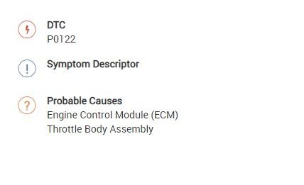

I attached the possibilities for the 122. The 223 is the same as the 122.
It looks like you need a throttle body itself. Make sure you do the relearn procedure when you are done.

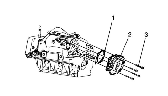

Throttle Body Assembly Replacement
Removal Procedure

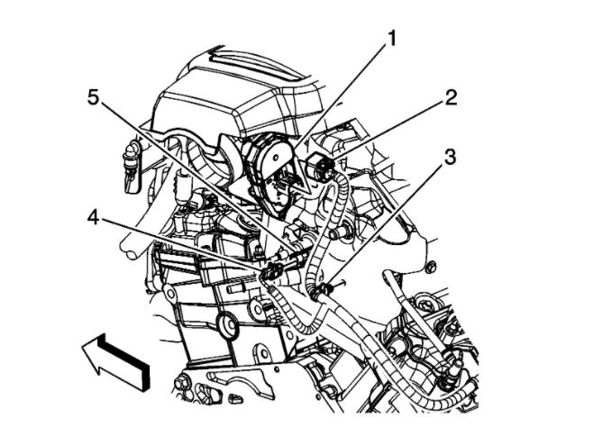

1. Remove the air cleaner outlet duct. Refer to Air Cleaner Outlet Duct Replacement (See: Air Cleaner Fresh Air Duct/Hose > Removal and Replacement).
2. Disconnect the engine wiring harness electrical connector (2) from the electronic throttle control (1).
3. Remove the throttle body bolts (3).
4. Remove the throttle body (2) and gasket (2). Discard the gasket.
