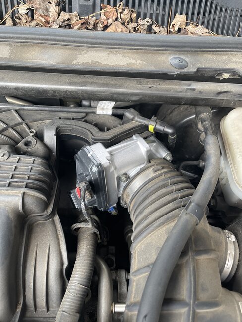

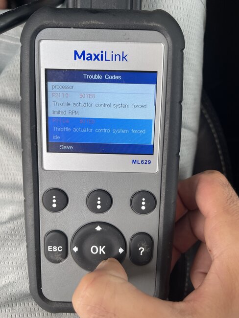

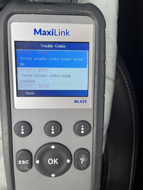

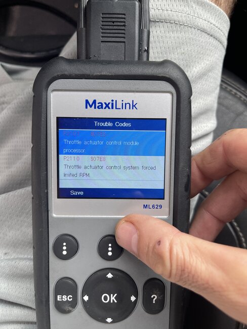

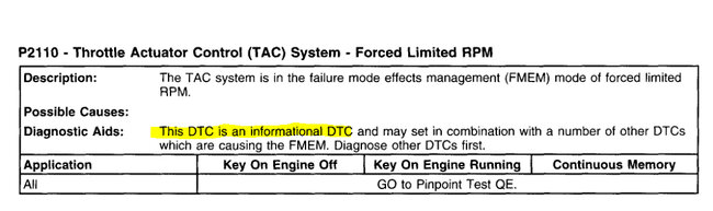

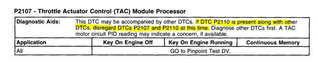

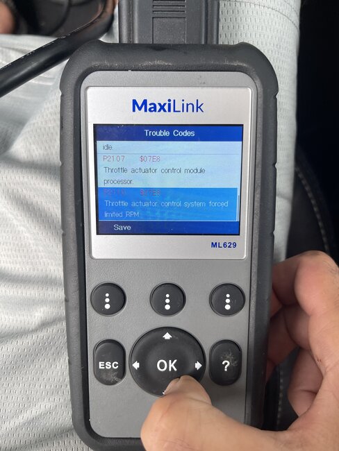

So, the current codes were those in the 3 first pictures. I deleted them to see what stays, but the check engine light went off so i drive it to see how it acts and there is barely any throttle response. Parked it and rescanned it but no current codes were available, only pending ones which can be seen in the last picture which has my thumb on the scanner. I have had a charger once do that and i cannot remember if it was the throttle body or what it was. Anyways, i looked under the hood and someone has already installed a new one thinking it might be it. While parked i can rev it now with the check engine light being off but once you drive there is no response. Also, i tried first to check on the engine mount by powering gas and pedal but there was zero response, i could not even get the engine to move a bit.

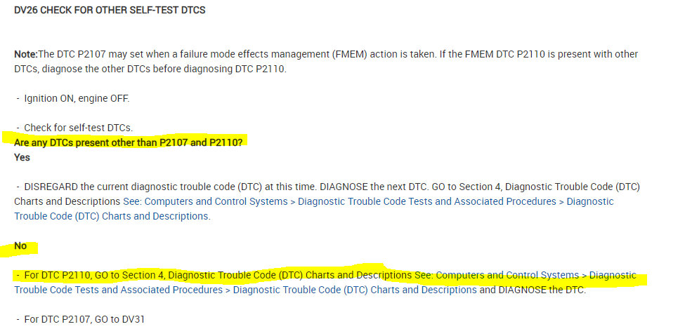

The P2110 is a generic code identifying the TAC is in failure mode. The P2107 is also related to a failure in the control system.
I started digging and need confirmation that code P2110 is the only one present. I realize that scan tool indicates that code, but has the P2107 returned?
Also, I need you to disconnect the TPS connector and inspect the connector pins to make sure nothing is shorting.
Sep 6, 2024 at 8:13 PM
BHAMDOC1973
  • 2,007 POSTS
2107 and 2110 are the ones that came back. And when you restart the car throttle is there but hardly there while driving.
Sep 6, 2024 at 8:21 PM
  • 110,194 POSTS

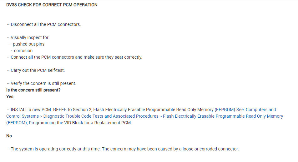

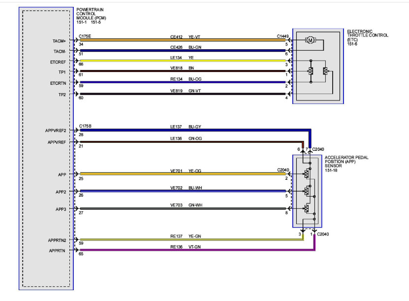

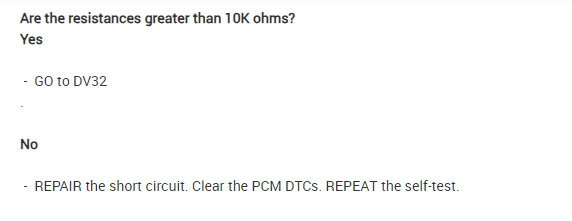

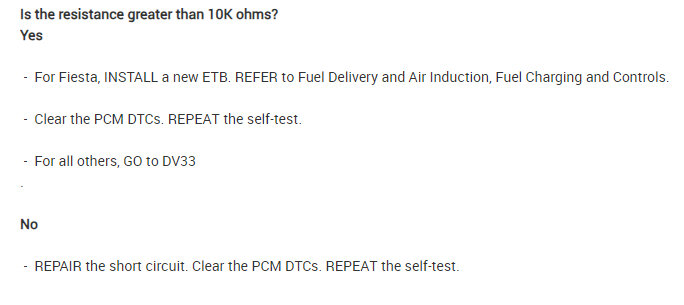

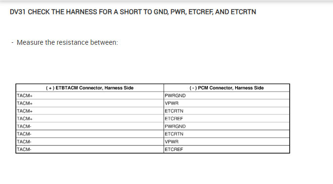

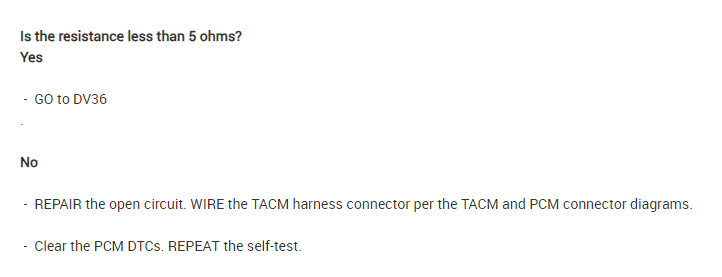

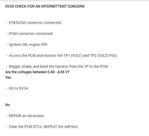

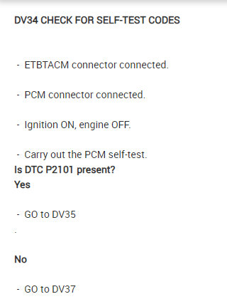

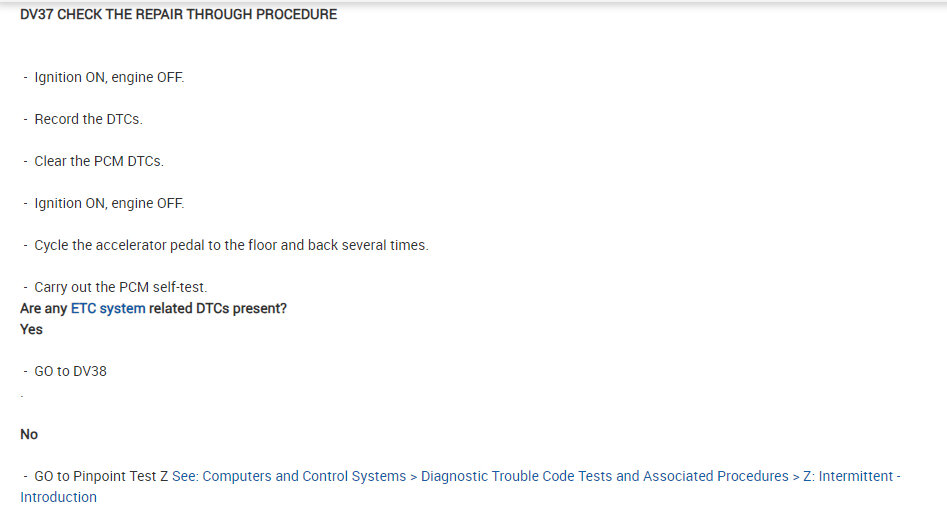

Okay, if both are present, we need to go to test DV. If you look below, pic 1 is a wiring schematic for the circuit. I suspect there is a short at some point, but to confirm that, we need to start tracing wires and checking resistance.
Starting with pic 2, I included the diagnostics. With both codes present, the manual indicates to start at DV31.
Take a look through the diagnostics and let me know if you are comfortable performing them.
Sep 6, 2024 at 9:24 PM
