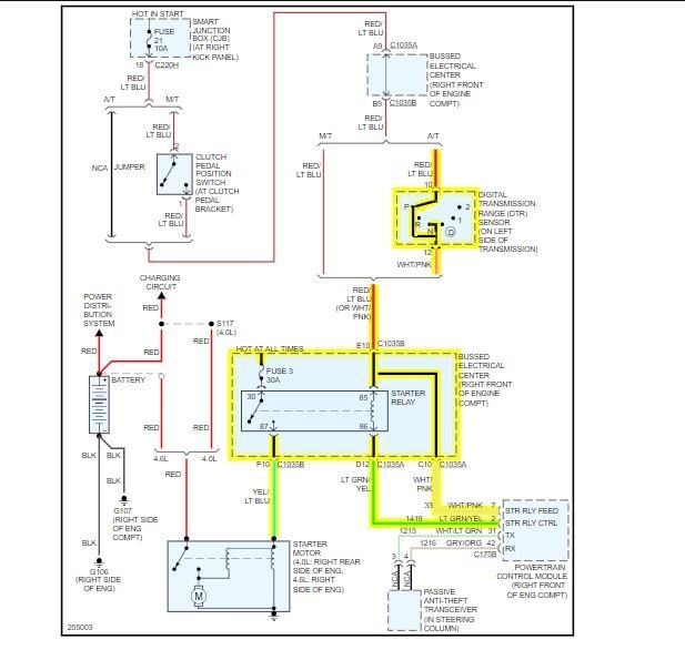

No start. I unplug the throttle body motor and then I get it to crank but no start and if I plug it back in it just clicks. what could be the problem?

The throttle body connector has nothing to do with the starter working.
What connector? Can you post a picture of the connector for me to see?
I attached a wiring diagram for you to view of the starting system.
