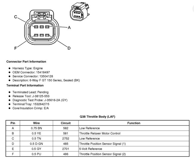

SQM
  • 6,383 POSTS
See attached for the pinout of the sensor.
It shows the wire color and locations.
Let me know if you have any questions.

SQM
  • 6,383 POSTS
On the diagram you will see the column with "wire", that has the letters that represent the color of those wires.
All you will have to do is to splice the wires from the connectors of the factory harness.
Just pay attention to the location of each wire for the factory and splice accordingly.
Let me know if this clears it up.

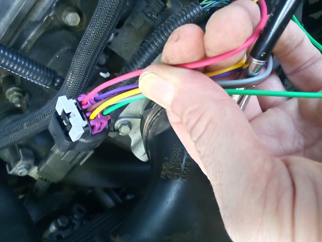

Okay, the connector I'm trying to splice into the wiring harness is pictured below. It's a pigtail connector having the following:
a) yellow, b) brown, c) red, d) green, e) grey and f) purple.
The existing wires from the harness are as follows: tan with a blue stripe, tan with a green stripe, tan with red stripe, tan with a
white stripe, solid yellow, brown with black stripe. I don't have an original TPS connector and I'm having trouble figuring out which wires from ECM to splice where to pigtail connector that connects to throttle position sensor.

SQM
  • 6,383 POSTS
The connector picture that you sent has the same color as the diagram on the manual, which represents the factory colors. If possible please upload the picture of the factory harness.
