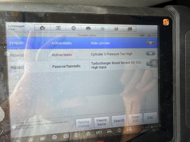

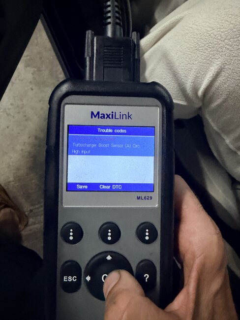

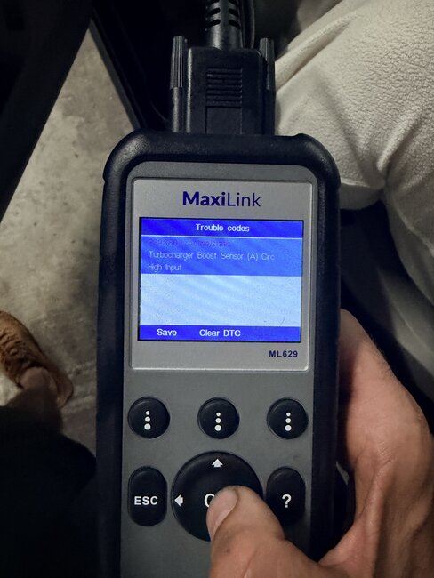

Driven it a bit and it was fine then on the way home epc came on and car shudders for a sec and is weak puled codes, ugh

If this is the sensor in the boot i removed which goes frim throttle to the air cooler then i cleaned it before i installed it because the hose had some oil in it. Not sure about the other codes or why they popped up. Its one thing after anorher
Jul 2, 2026 at 6:55 PM
  • 55,691 POSTS
Okay, this is a different issue than the original, let start a new thread.
