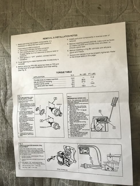

I removed the throttle body in my car (V6 MPFI)
Already cleaned and disconnected sensors.
Ordered gaskets and received them today.

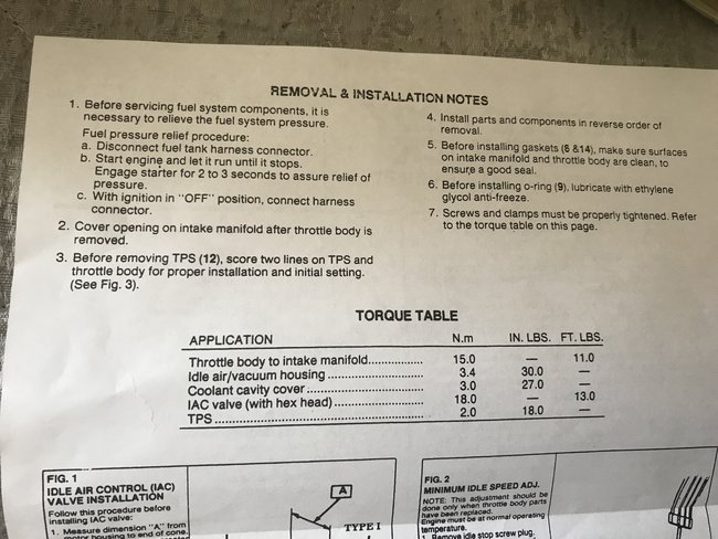

Found this worksheet in there with these instructions.
I did not know I had to do any of this. What should I do?
Is my car going to run bad now?
How can I correct this?

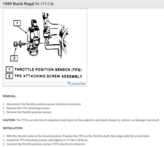

I do not think you hurt anything. Here is a guide that shows what you should do when servicing the throttle body. You did not remove the TPS?

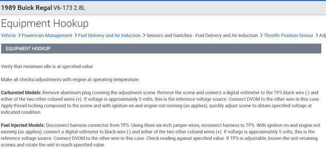

Hi Ken, I was just wondering, my TPS sensor is due for replacement soon because it is the original part? My MAP sensor is getting replaced and I want to replace the TPS also because been experiencing some of the issues. Regarding when it is time to replace the TPS sensor. Can I just install the new one the same as I did with putting the old one back on? Then disconnect the battery for five minutes to prevent any issues and it should start and ECM will relearn it if I go for a test drive.
Sep 10, 2018 at 1:05 PM
  • 55,688 POSTS
Here is what the book has to say about replacing the TPS sensor. Check out the diagrams (below). Please let us know what happens.
