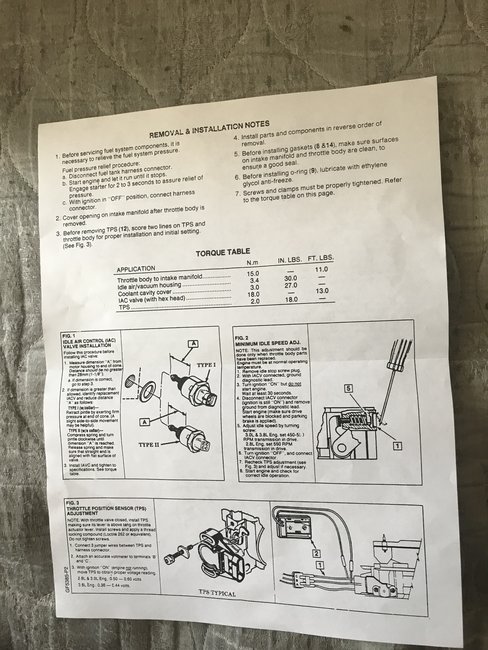

Found this worksheet in there with these instructions.
I did not know I had to do any of this. What should I do?
Is my car going to run bad now?
How can I correct this?

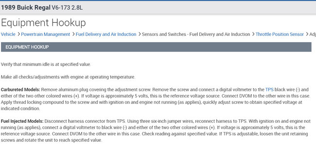

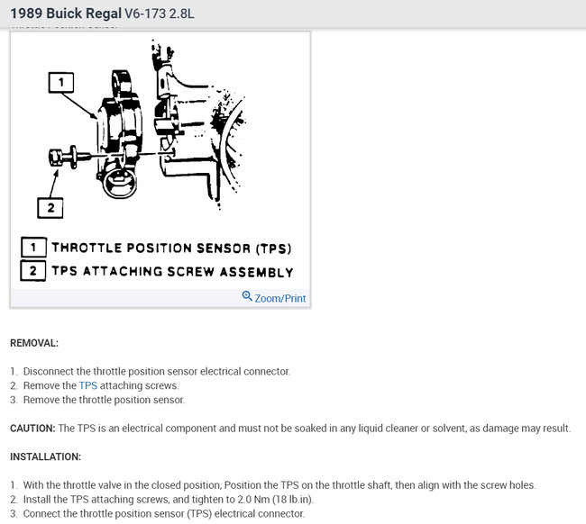

I do not think you hurt anything. Here is a guide that shows what you should do when servicing the throttle body. You did not remove the TPS?

You will need to install those in the exact same place can you see the marks on the TPS where the screws were? You should be okay. Let me know how it goes.

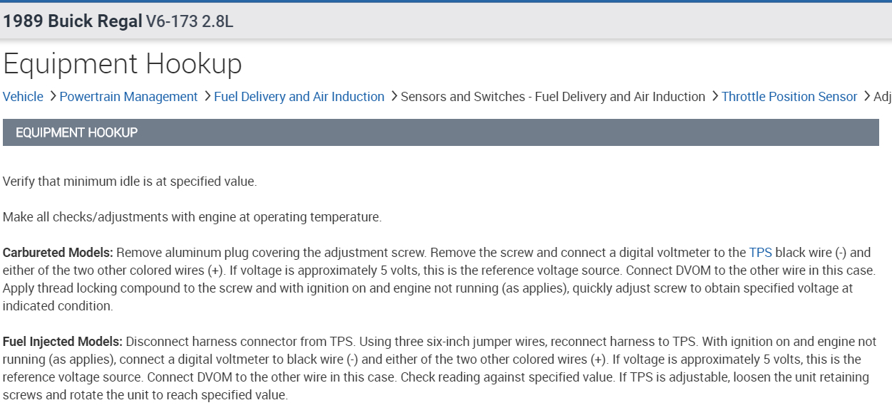

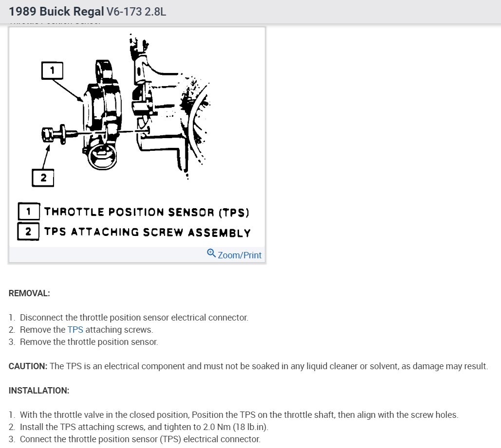

Hi Ken, I was just wondering, my TPS sensor is due for replacement soon because it is the original part? My MAP sensor is getting replaced and I want to replace the TPS also because been experiencing some of the issues. Regarding when it is time to replace the TPS sensor. Can I just install the new one the same as I did with putting the old one back on? Then disconnect the battery for five minutes to prevent any issues and it should start and ECM will relearn it if I go for a test drive.

Here is what the book has to say about replacing the TPS sensor. Check out the diagrams (below). Please let us know what happens.
