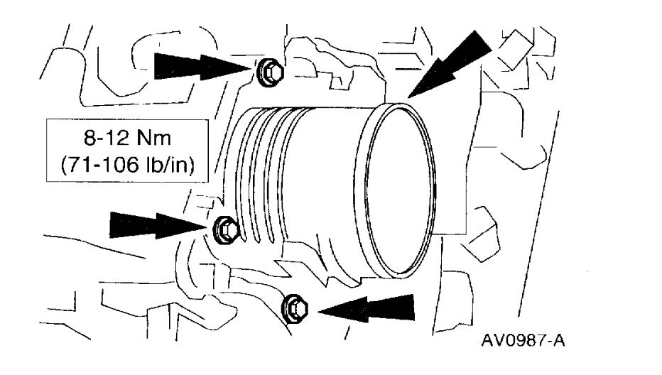

Throttle body bolts size
2002 LINCOLN TOWN CAR
180,000 MILES • 4.6L • V8 • 2WD • AUTOMATIC
CRYSTAL OSM
Replacing my intake manifold, rebuilding stage. I need to replace my throttle body bolts with new ones. Anyone have the bolt size/specs available?
Thanks
May 9, 2019 at 4:17 AM
Good afternoon,
The bolts are 8mm 1.25 thread pitch about 1 1/2 inches long. You can also take one of the old ones to Fastenal and match them up. Check out the diagrams (Below). Please let us know what you find. We are interested to see what it is.
