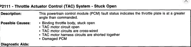

I changed my spark plugs out and after I reconnected everything I started my car and it instantly started idling rough and threw a P2104 and P2111 code for throttle actuator stuck closed. I’m not sure what to do or if I need to buy another one?
May 20, 2020 at 1:35 PM
  • 110,241 POSTS
I'm sure it's something simple. First, I attached a pic below that shows the possible causes of the P2111. That is the stuck code you indicated. The other code is to indicate the vehicle is in a "fixed idle" mode.

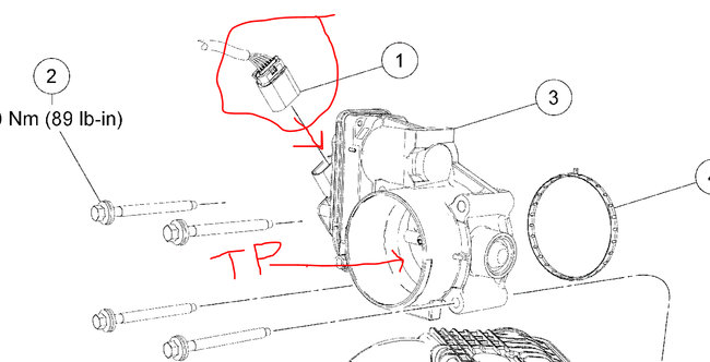

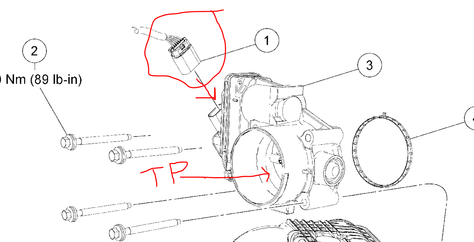

Now the throttle body is on the intake. If you follow the air intake tube from the air filter box, it will lead you to the throttle body (TB). Since this just happened, check the following:
1) Did you disconnect the electrical plug in pic 2 (circled)?
2) Make sure that connector is tight and not damaged.
3) I have an arrow titled TP which stands for throttle plate. Look at the TP and make sure nothing is preventing it from closing.
__________________________________________
Since this happened after the work was done, I suspect a wire is disconnected, pinched, or something is preventing the TP from fully closing.
Let me know what you find.

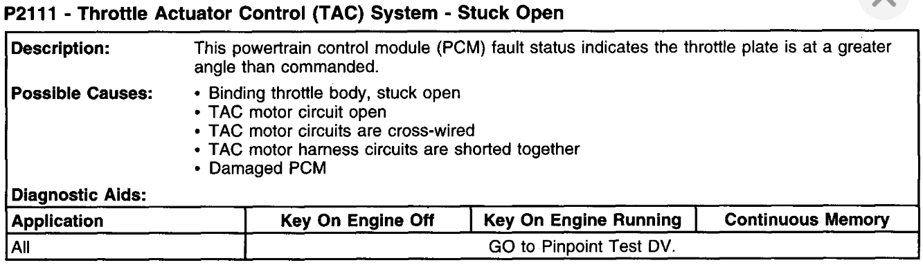

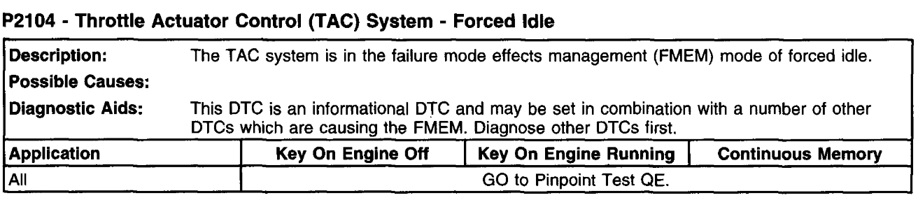

Hello, I'm Danny.
Here a re a few things to check for relating to those 2 codes. I've attached them as pictures below.Hope this helps and thanks for using 2CarPros.

Yes, I did disconnect that plug. I made sure it there was no damage done to it and connected it securely. As far as I can see there is nothing in the way from preventing it to open up. So confused just wanted to change my plugs and caused a bigger mess.

Allen, did you make sure the plug to the TB is placed and not reversed?

JACOBANDNPICKOLAS - changed spark plugs on 2015 Santa Fe, started engine and went into limp mode. Pulled DTC P2104. Seen your diagram above, double checked my TB, didn’t connect the connector!! Thanks. I would have sworn I hooked everything up right. Didn’t even notice it on the bottom of the throttle body.
