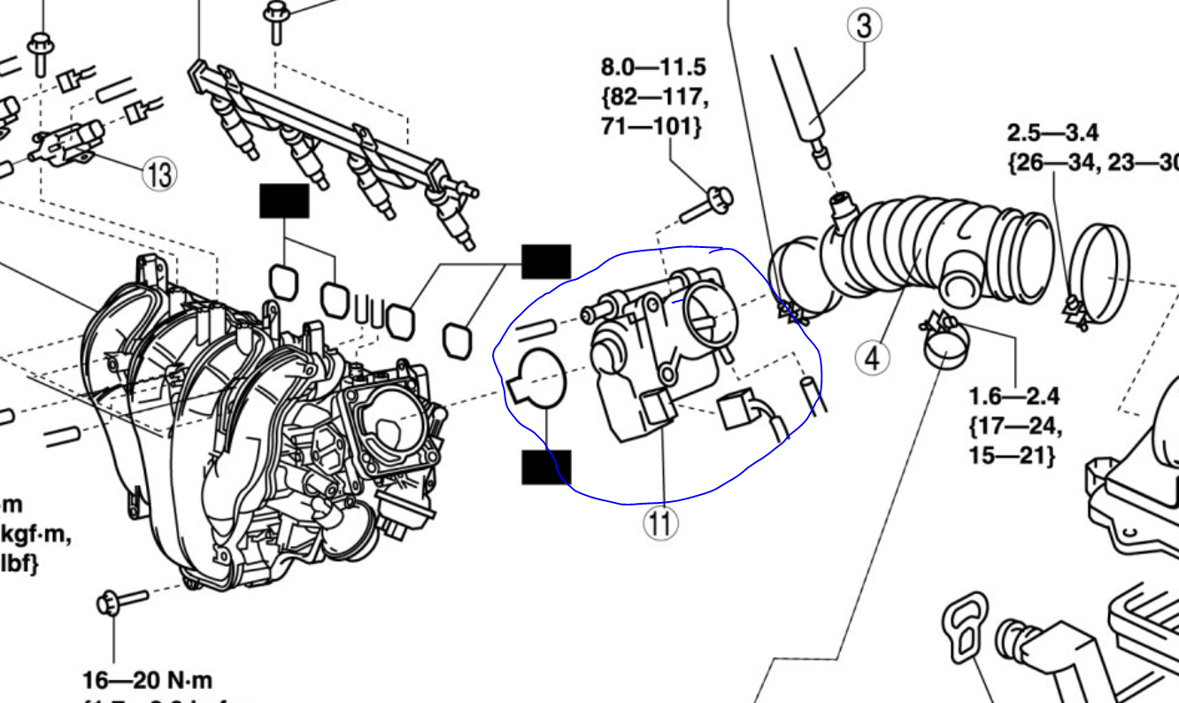

I have change the for the car listed above but I need to know if I need to make a relearn to it. The problem is that now it doesn't work. I press the gas pedal and doesn't do anything.
Can you help me?

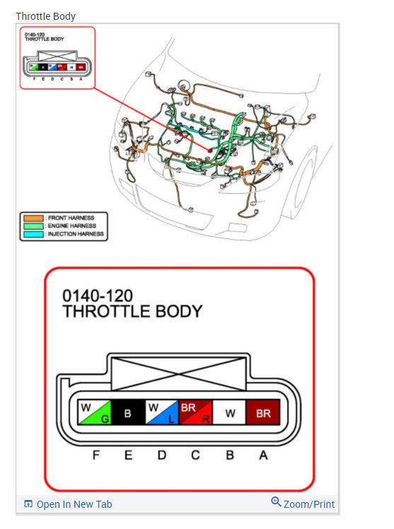

Good morning,
I attached the location of the throttle body. It is on the end of the upper intake manifold. It is held by 3 bolts, an electrical connector, and a hose.

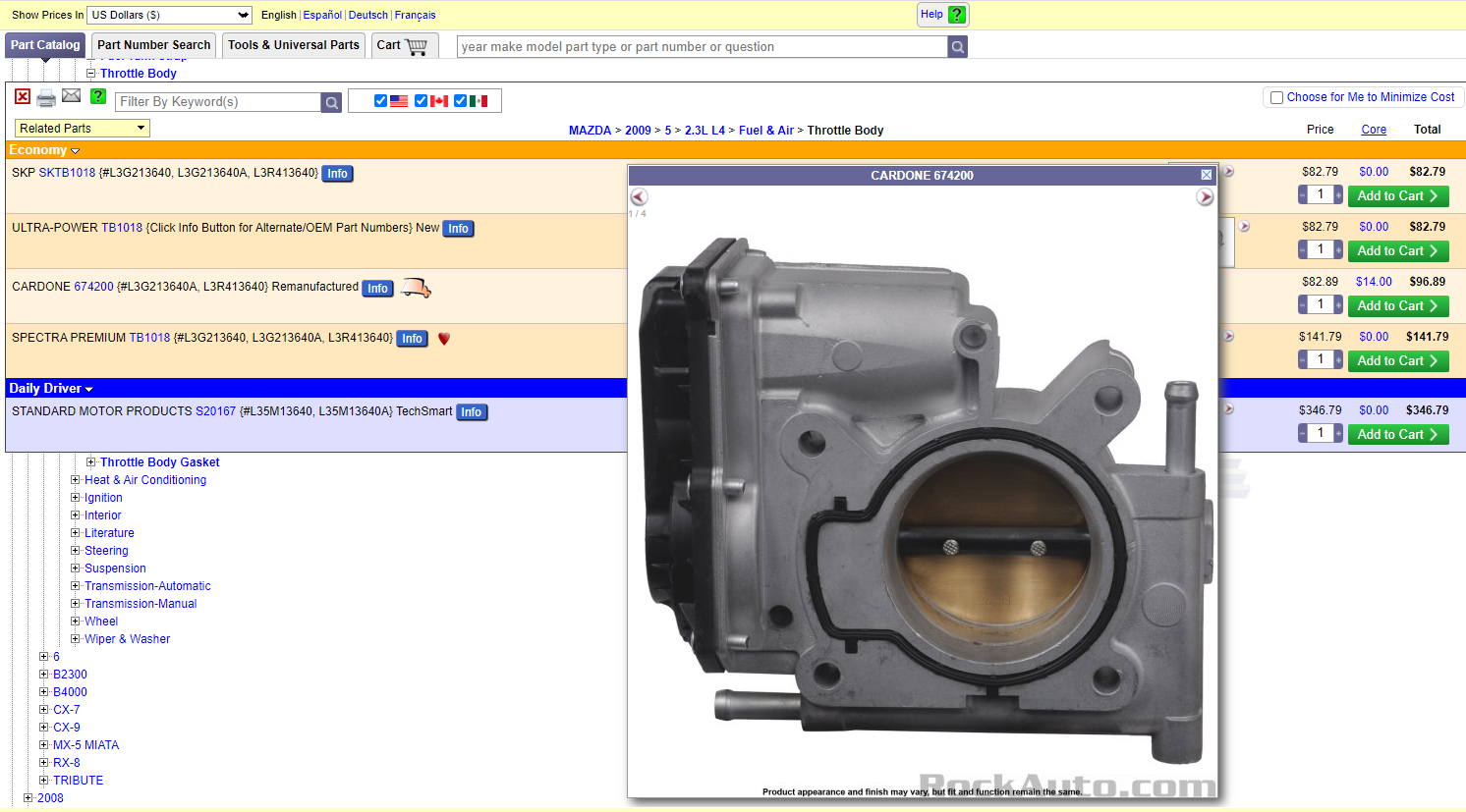

There is no relearn for this. It is a plug-and-play replacement. I attached the part as well for you.

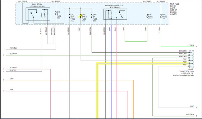

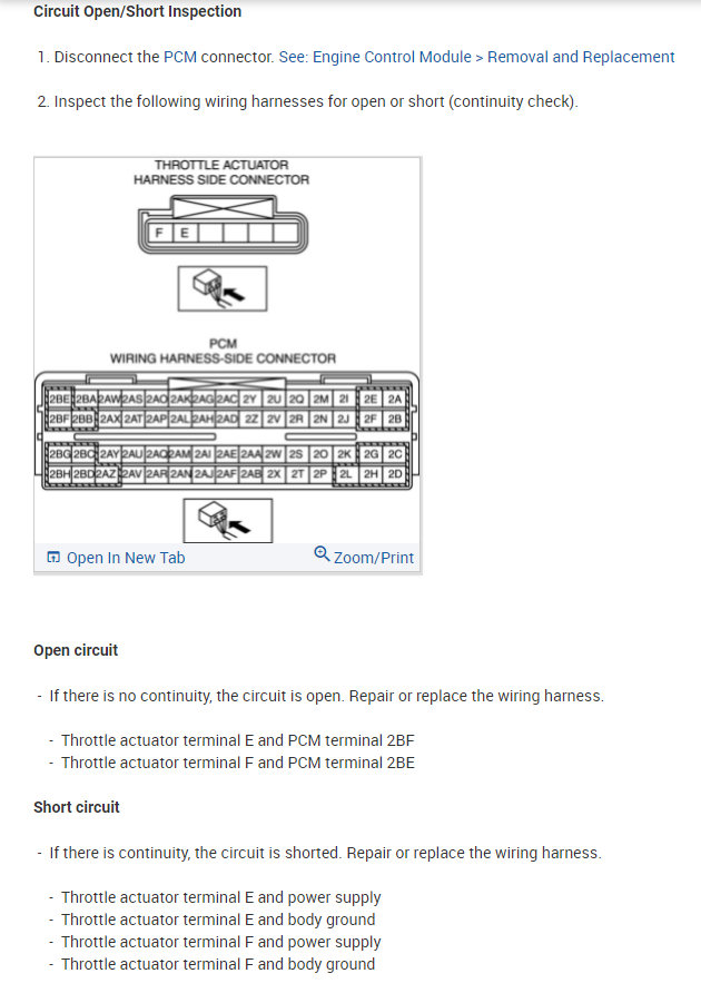

Hi. I change the throttle body but it didn't work. Does not accelerate. I have a signal from the acceleration pedal. I looked for the connection for any damage, but everything looks fine. Is there any relay that controls the throttle body? Can you send me how to test the ECM to see if it's working correctly?
Thank you,
Juan Marin
Sunday, July 4th, 2021 AT 7:44 AM
  • 52,797 POSTS

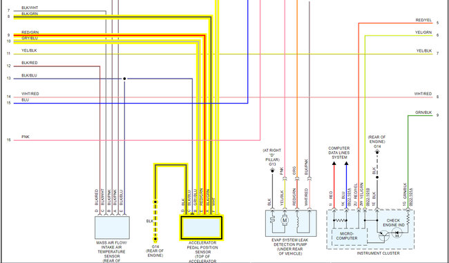

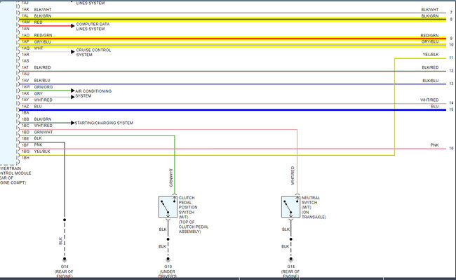

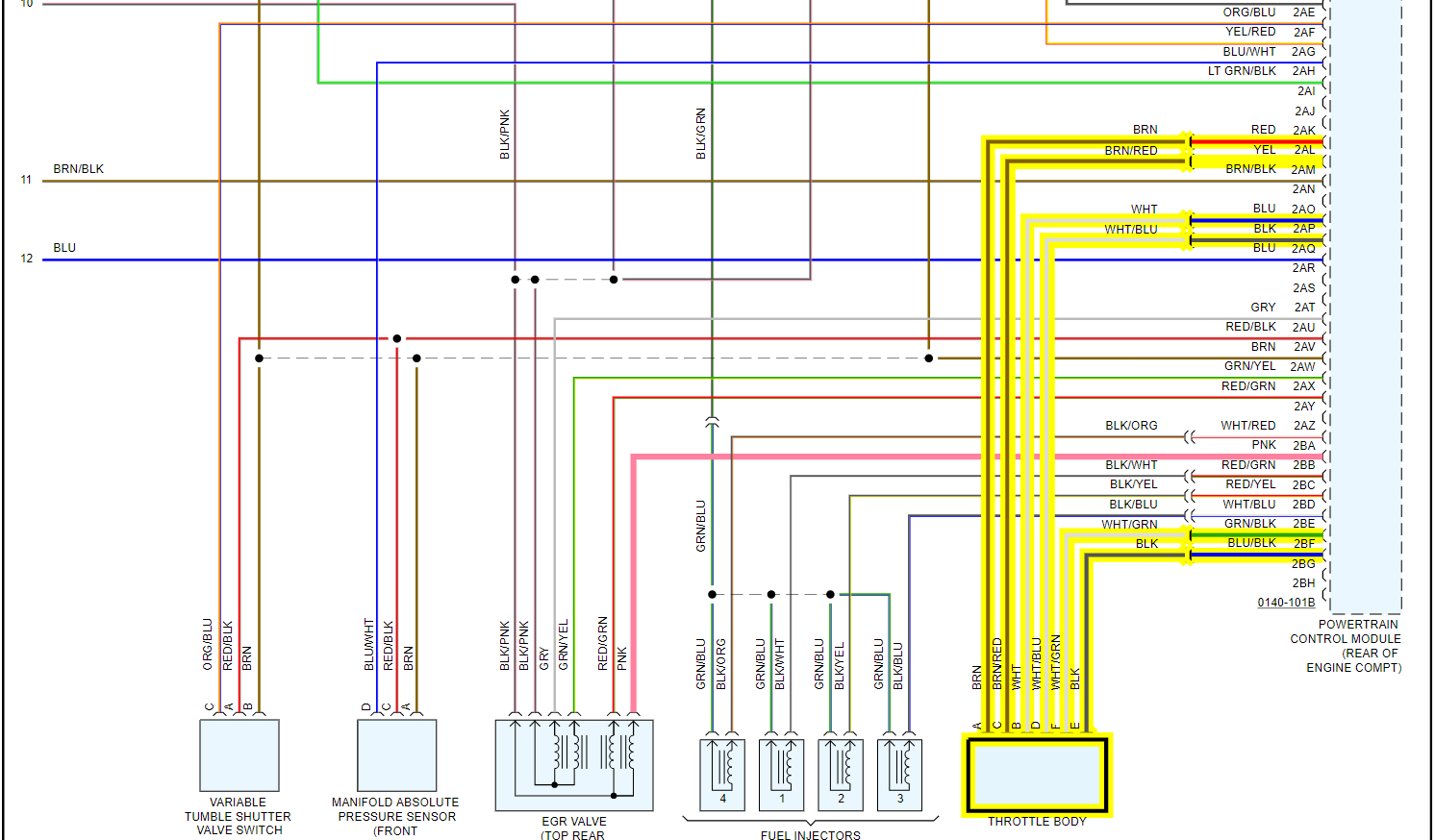

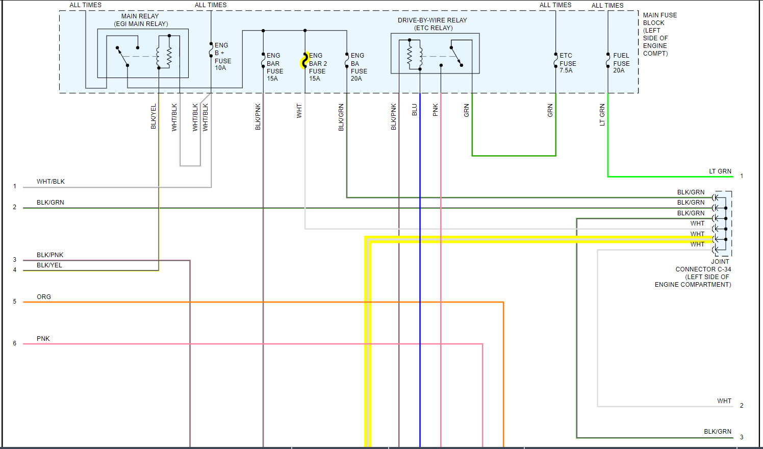

Okay, do you have an advanced scan tool that can read the commands to the throttle body?
I attached the wiring diagram of the system for you. I highlighted the wires for you of the throttle body and the pedal sensor.
I also attached the flow chart for the throttle body operation.
