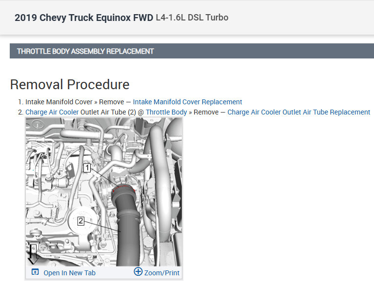

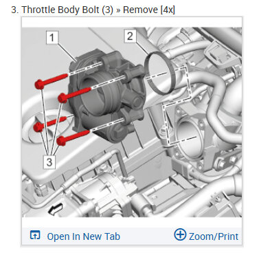

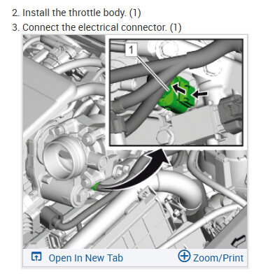

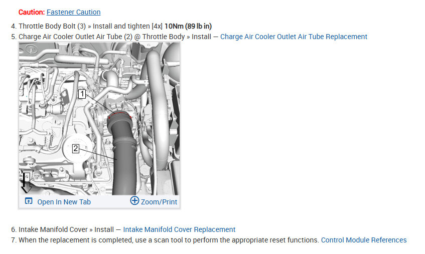

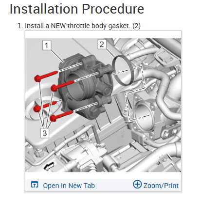

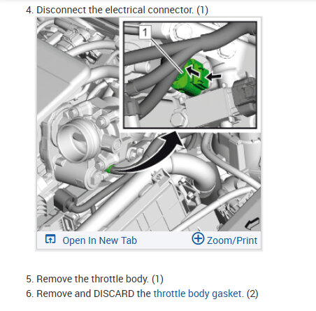

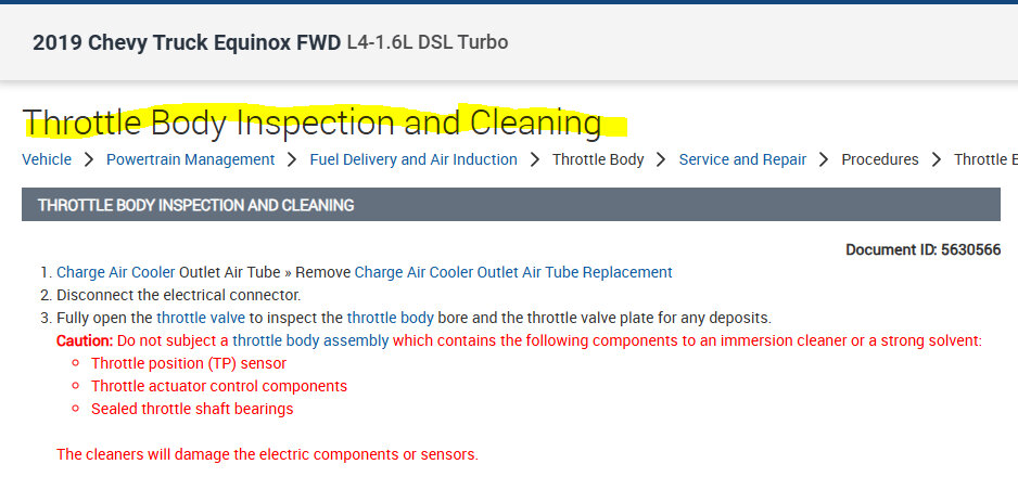

I have the vehicle listed above Turbo Diesel and I need an image of how to remove and clean the throttle body.
Nov 21, 2024 at 7:17 AM
  • 110,236 POSTS

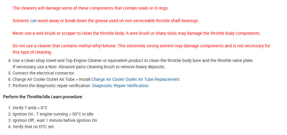

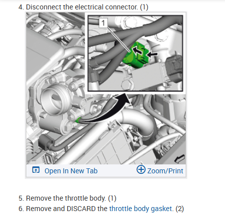

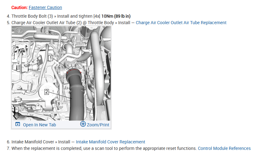

If you look below, I attached the directions for removing and installing the throttle body. Additionally, I attached directions for cleaning and inspecting it.
