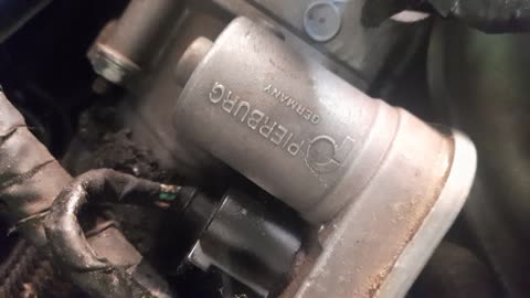

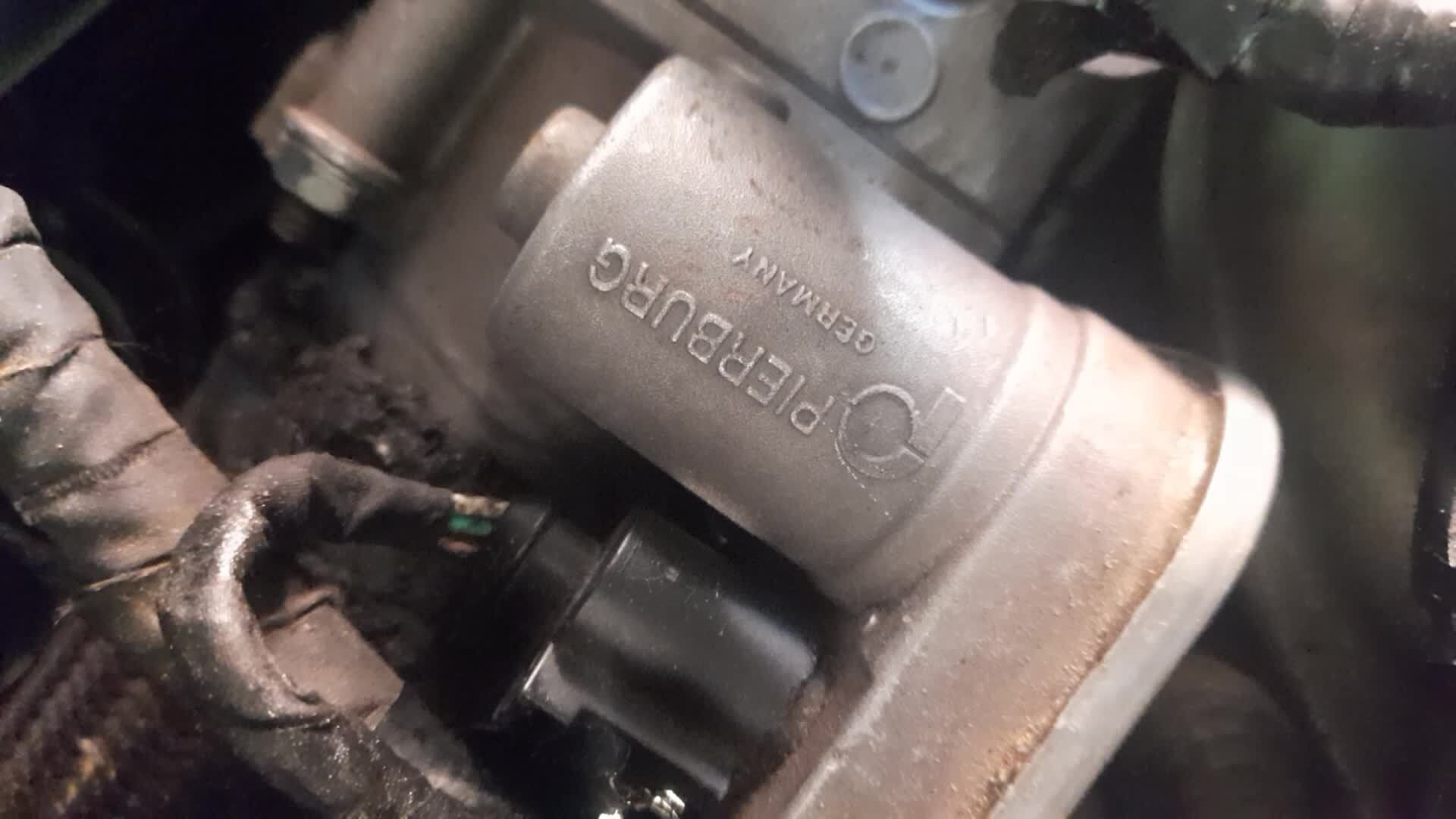

When i cut off the engine the electric power remains feeding the throttle body and i hear low whistling coming from the throttle body.

I want to add that the engine starts and accelerates without any difficulty. But every morning I find the battery drained.

Sorry, the sound coming out from the throttle body is very low.it seems that the electric motor is unable to close the throttle body gate. But when I take off the battery negative wire, the gate gets closed.

No problem, I would unplug the throttle body to see if the noise goes away and if so, replace the throttle body. Thanks for the video, it helps.

It's exactly like what you said.

Today i'll replace a new throttle body.

Is a bad reprogrammation can led to the problem I encounter in the throttle body ? My throttle body remain open after turning off the engine.

That can be normal as long as it closes on start up.

But it remains open after I cut off the engine.

Yes, this is to allows gas fumes to dissipate, I think it is normal but you can try a new part and see if it does the same thing.
