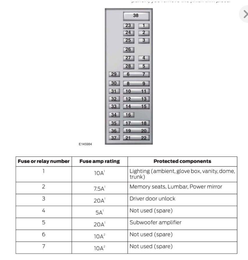

i'm trying to check the fuses where are they and how can I check them?

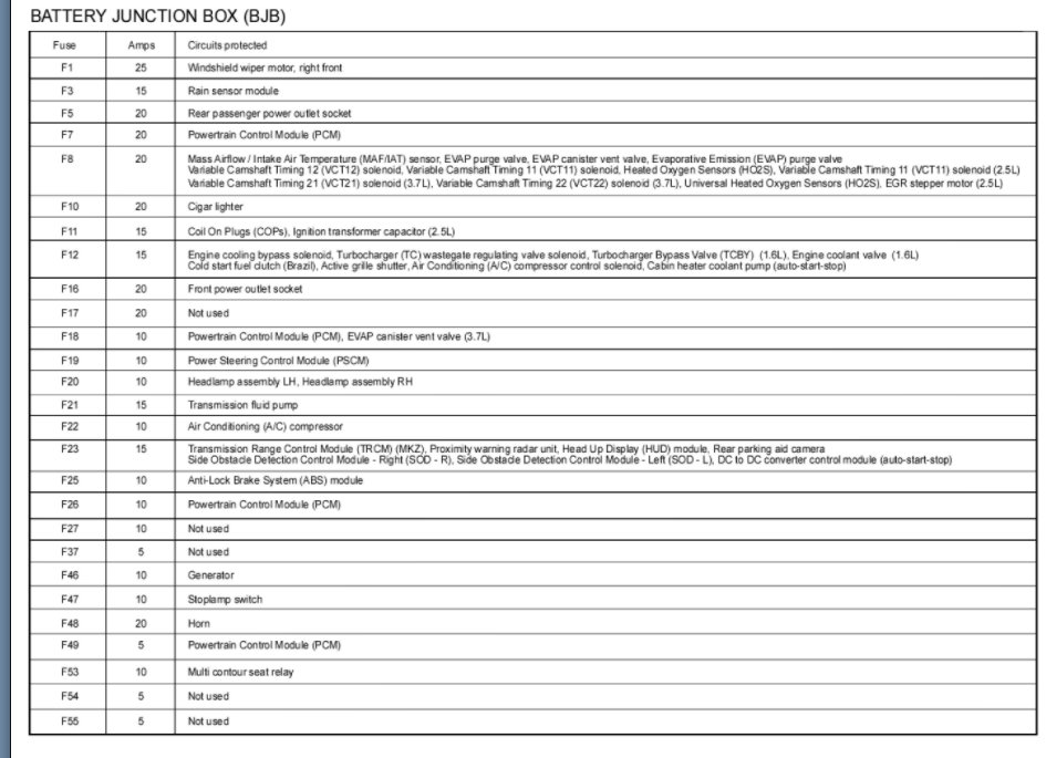

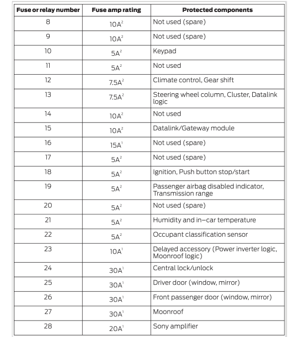

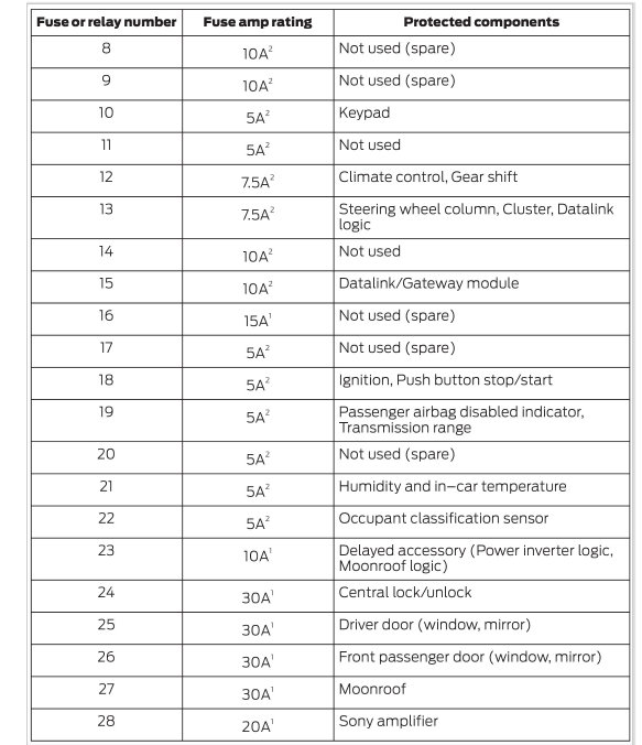

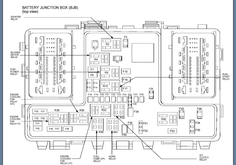

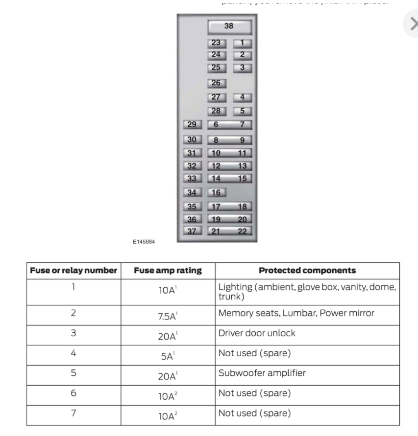

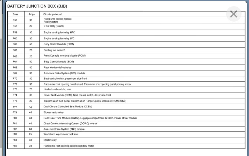

Here is a guide that will help with testing and replacing the fuses by giving step by step instructions:
Below is the info from the manual that will help with locating and identifying the fuses.
Please run through this info and let us know if you have other questions. Thanks
