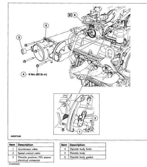

dropped screws down in the throttle body , is it possible to retrieve them?
Apr 24, 2020 at 2:40 PM
Good evening,
You will need to remove the throttle body itself and then use a magnet to fish around for the pieces. Check out the diagrams (Below). Please let us know if you need anything else to get the problem fixed.

trying to remove throttle body to replace seals

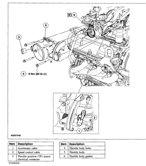

Hello Thanks for the donation Removal and installation procedures for your vehicle's throttle body are below..
https://images.2carpros.com/forum/automotive_pictures/261618_Noname_377.jpg
https://images.2carpros.com/forum/automotive_pictures/261618_Noname2_102.jpg

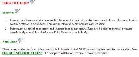

Sorry, the manual doesn’t provide much info on TB removal or installation. Here is what we have.
THROTTLE BODY
Removal
1. Remove air cleaner and duct assembly. Disconnect accelerator cable from throttle lever. Disconnect cruise control actuator (if equipped). Remove accelerator cable bracket and set aside.
2. Disconnect electrical connectors and vacuum lines as necessary. Remove 4 bolts (or screws) retaining throttle body assembly to intake manifold. Remove throttle body.
Installation

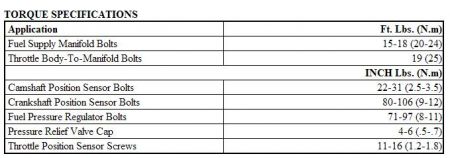

Clean gasket mating surfaces. Clean and oil bolt threads. Install NEW gasket. Tighten bolts to specification. See TORQUE SPECIFICATIONS . To complete installation, reverse removal procedure.
If you need more info please tell me your engine size in liter and the 8th digit of your VIN.
