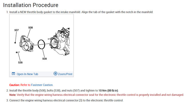

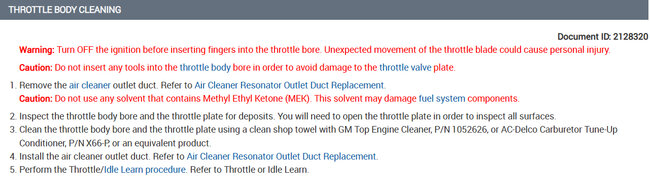

While still connected, the throttle body was cleaned, and the butterfly was opened manually. After reassembled the RPMs immediately go up to 2,500 and cannot get truck to move. If put in gear it does not engage at all. I included a video. It did go down in the video buy if I drive it after 30 seconds or so the RPMs jumps to 3,000 and the vehicle will not continue to drive, it's like it's in neutral.
Feb 23, 2025 at 6:54 AM
  • 55,688 POSTS

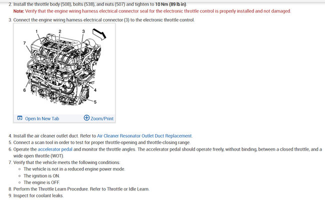

Yep, they don't like to be opened manually, we just leave them shut and clean around the bore the best we can or reprogram the throttle body. The truck won't drive because it is in limp mode.
This guide can tell you more:
https://www.2carpros.com/articles/reduced-power-limp-mode
Here are the instructions on how to do the job correctly. Clear the codes before you begin. Check out the images (below). Please let us know what happens.
