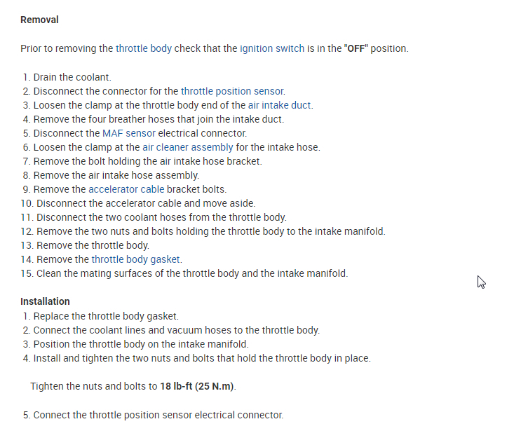

I am trying to figure out how to remove the throttle body and the proper way of doing it and what is involved.

Also trying to find out where my EGR valve is located so I can clean that as well.

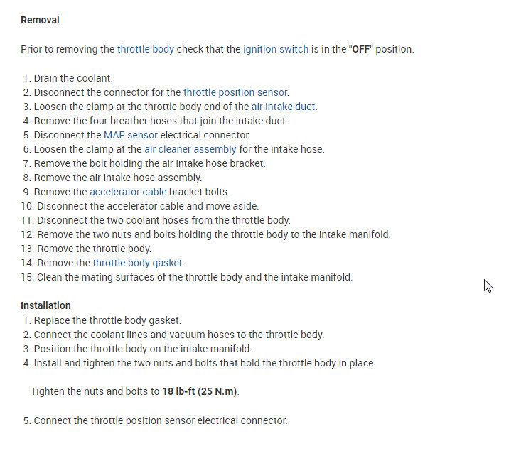

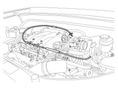

The throttle body is located at the front of the upper intake manifold. See picture 1. Some have two bolts others three bolts holding them in place. If you follow the air box induction tube to the engine, it stops at the throttle body.
Now, the reason you cannot find this online is because it is not recommended. Take a look through this.

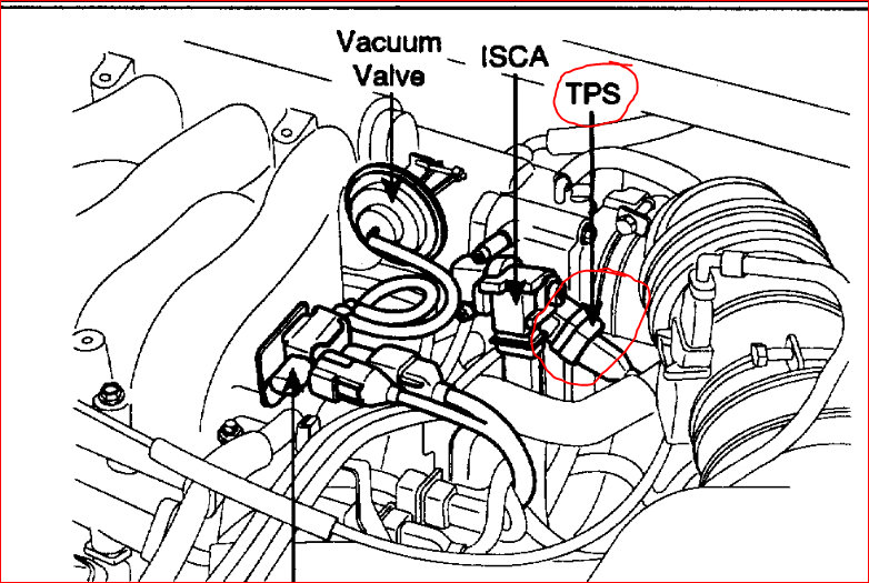

I have the EX model. I need to replace my throttle position sensor. I have been looking all over the place for pictures or diagrams of where it may be located. I have not found anything helpful. Any help would be great. The fault code is P0123. The car starts idling really low and the car motor will just stop running sometimes at a stop sign.

Hello, I am Danny.
I have attached a picture and circled the TPS in red. Hope this helps and feel free to ask any other questions if needed. Thanks for using 2Carpros.

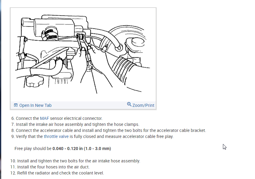

Can you get a couple pictures of the line you are looking at? However, if there is coolant in it then that is a coolant line. You have coolant lines running to the throttle body so that the engine controller can regulate the temp.
I am attaching the process below of how to replace the throttle body.
Is there a reason you need to replace the line? If it is not leaking then you do not need to disconnect it.

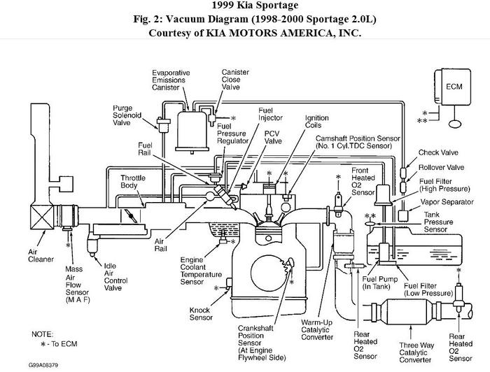

What I am looking for is for the two lines on the bottom of the throttle body itself. Not the plenum. There are only 2 lines coming off the bottom of the throttle body so this should be easy. Diagrams are not showing them properly. Just looking where these lines go to. Thanks.

I can only find this diagram in our database. Hope it is helpful.

It is not in that diagram. Probably will require someone to actually look at their vehicle. Thanks though.
