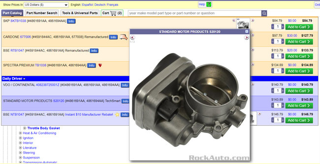

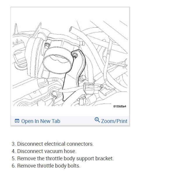

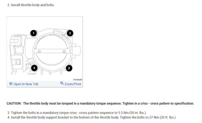

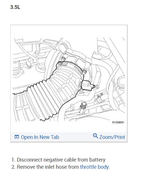

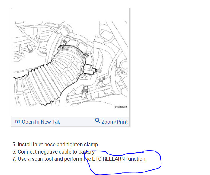

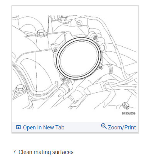

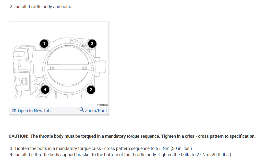

I am trying to figure out how to replace my throttle position sensor and I am needing to know where it is located is it a part of the throttle body.
Apr 29, 2021 at 8:56 PM
Good morning,

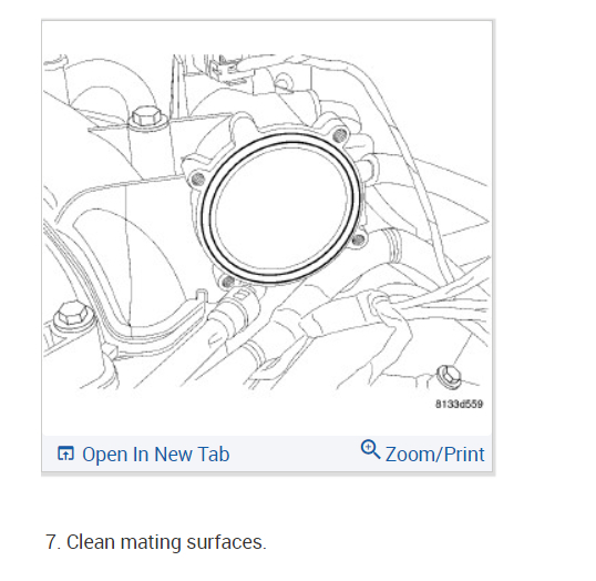

I attached the procedure for replacing the throttle body for you. The throttle position sensor is part of the throttle body and cannot be replaced separately.
I also attached the part for you to view as well.
