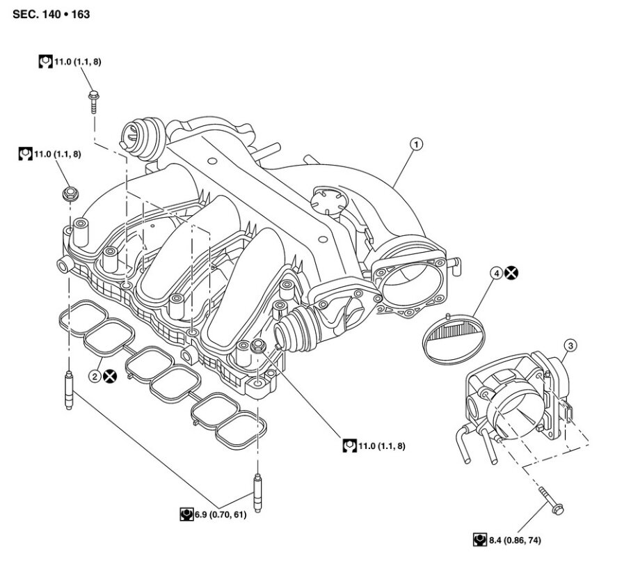

Throttle body, dashboard orange engine light turned on?
2016 NISSAN TERRANO
10 MILES • 1.6L • 4 CYL • 2WD • MANUAL
GAVHANEGN
On dashboard orange engine light coming after scanning fault related to throttle body. cleaned throttle body and erased fault through scanner but after long drive that fault appeared only when long drive in single trip of say 100km. No hunting no any problem observed during presence of dashboard sign.

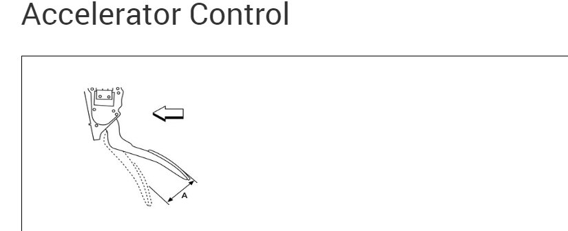

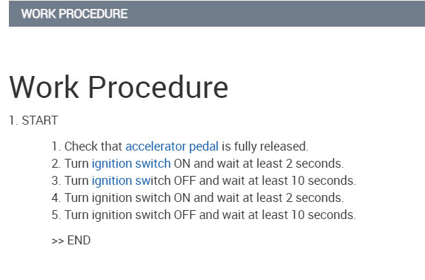

What is the fault code number please? It could be the throttle body needs replacement or the throttle pedal position sensor is going out. I have included the locations and how to replace both parts and the relearn procedure which you might want to try before doing anything else. Check out the images (below). Please let us know what happens.

Dear Sir,
My vehicle is running smoothly. The only problem is that after erasing fault it appears only when after driving continuously for say 100km or more and when u stop and again start at that time the fault come for short trip fault never come. The code of fault is P2119 on scanner.

The P2119 code in a 2016 Nissan Terrano refers to a problem with the throttle actuator control throttle body range/performance.
