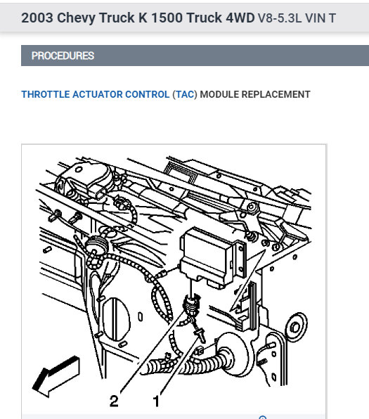

Throttle Actuator Replacement?
2003 CHEVROLET 1500
200,000 MILES • 5.3L • V8 • 4WD • AUTOMATIC
WALDOW

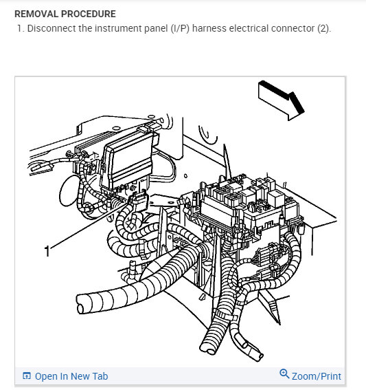

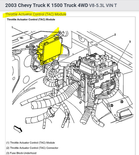

Part #12588923. Looking to find out where this part is located so i can replace it. It makes my truck go into Engine Reduced Mode. I changed out the sensor on the throttle body and it is still doing the same thing. So, i read codes and says i need to replace the actuator.
Apr 1, 2023 at 5:42 AM
  • 110,244 POSTS

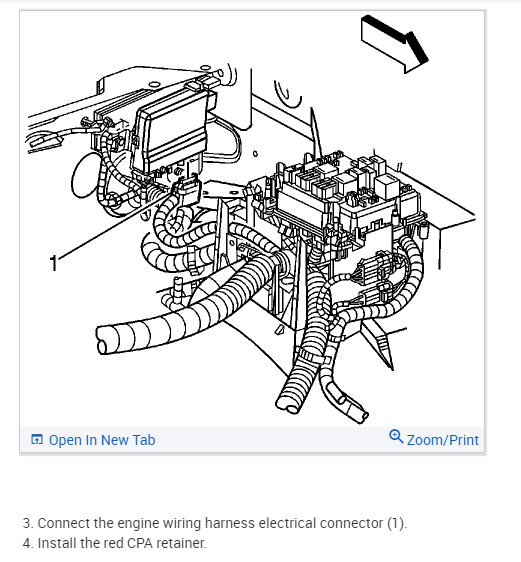

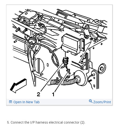

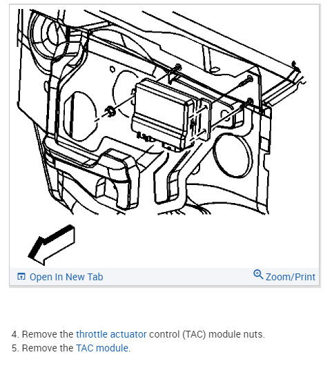

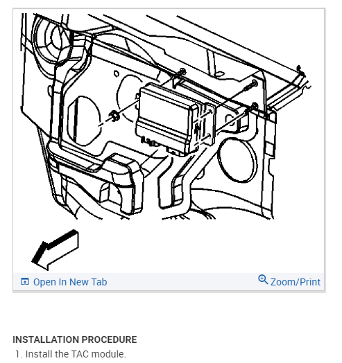

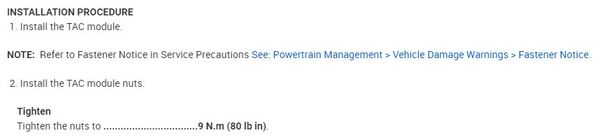

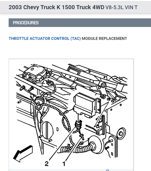

That is the throttle actuator control module (TAC) module. I attached a pic below of the component to help you locate it.
Additionally, the remaining pics are the directions for the removal and replacement of the module.
Let me know if this helps or if you have questions.
See pics.
