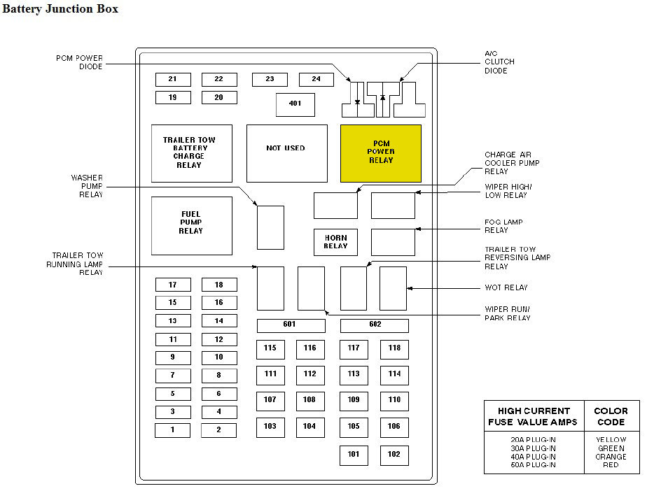

Mechanic just got me for almost $800.00 for a new computer. I drove off the lot and didn't even make it home. I was going down the road and the engine just shut off. I pulled in a parking lot and tried to read crank it. on regular attempts it seems like I was going to get a crank out of it I see the def light is flashing on the dash.
Jan 9, 2020 at 10:20 AM
BMDOUBLE
  • 1,139 POSTS
When your truck is not starting, try and swap the PCM relay with another relay that looks like it or just replace it if it is original. I've fixed lots of these trucks with the same scenario of other shops replacing the PCM and the vehicle still doesn't start! PCM relay has been the fix for at least 90% of the ones that I've had this issue with.
