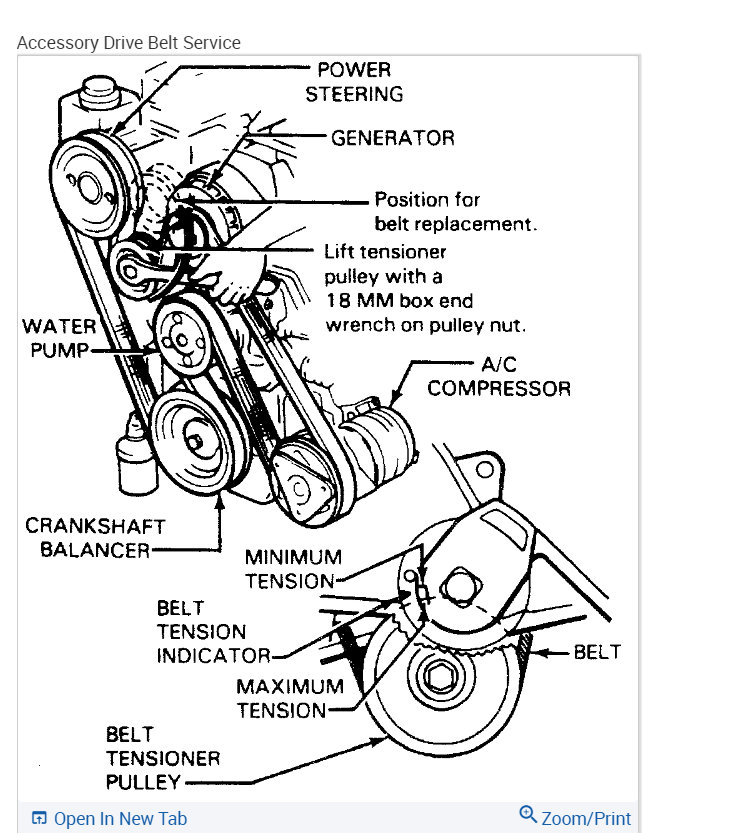

I can't find any information about this car related to the three belts for the Alternator, Water Pump, Steering wheel, AC, etc.
Does anybody know where to get a diagram for these belts, and what tools do I need to change them?

Yep, here you go check out the images below for the serpentine drive belt diagrams. Please let us know if you need anything else to get the problem fixed.
