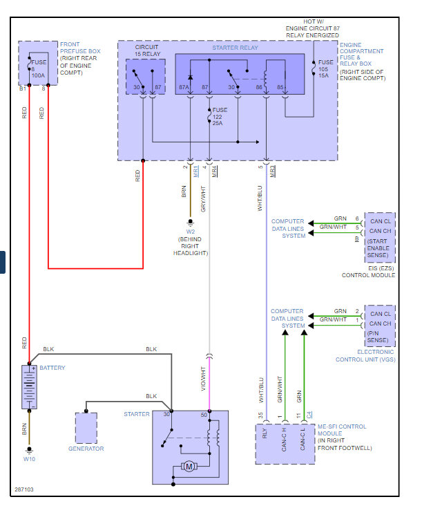

This vehicle cannot start from ignition switch. When you turn on the ignition switch, you will hear a click sound on the starter motor as if the starter wants to engage. When you turn and hold the key, the ignition light will be turned off and comes on again but cannot start, and also there was no power to dlc terminal 16. What's the cause of this no crank? And also, how do I locate circuit 15?
Oct 13, 2022 at 7:48 AM
  • 55,721 POSTS

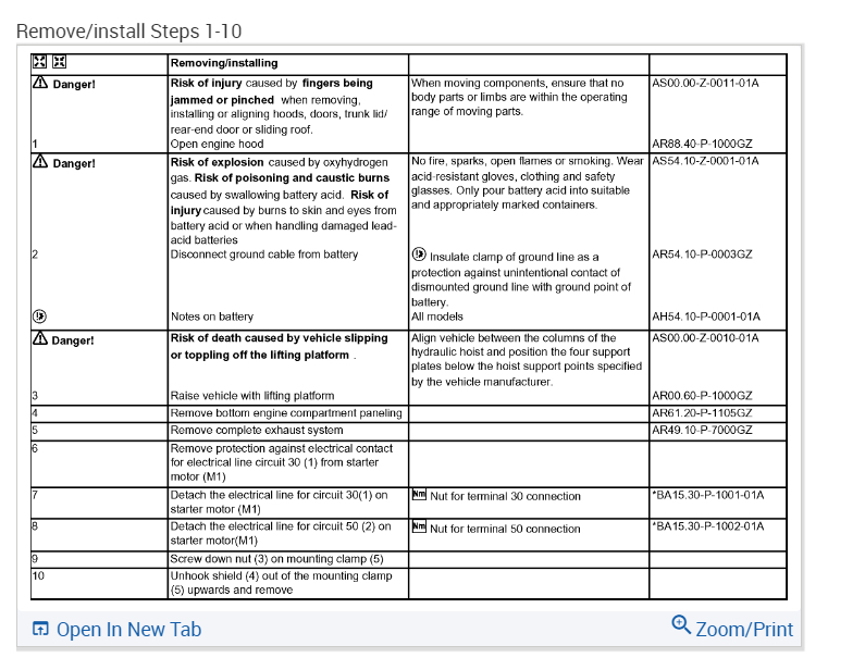

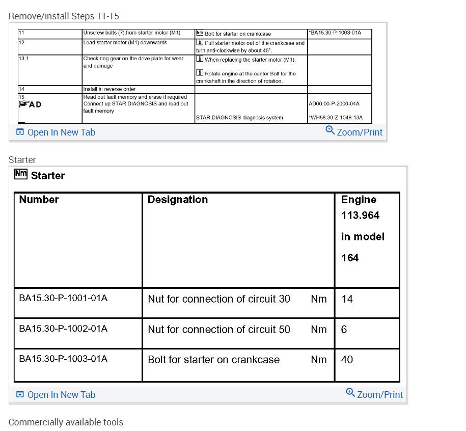

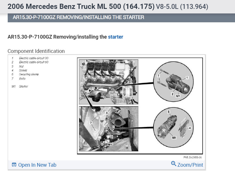

Is the battery in good shape? If so, it sounds like the starter or starter relay is not working. here is the starter wiring diagrams so you can see how the system works and a guide on how to test the relay and starter:
and
The starter relay and relay circuit 15 are in the fuse panel under the hood. Check out the images (below). Please let us know what happens.

Well, the battery is drained but I used jumper cable and battery well charged to power it up. Could it be that the jumper cable is where the contact is having weak connection by making that voltage leak sound.
I used test lamp and DMM to check battery voltage on terminal 30 of circuit 15 relay and there was power. I check terminal 85 of starter relay when ignition is turned on, there's power, I check terminal 86 the ground signal from ECM and it reads 3.7V, I check 87a to ground and there was ground. I checked 87 and 30 and noticed that it closed but the starter solenoid ignition output was not reaching to starter solenoid. Could it be faulty EIS control unit. And if so, how do I test EIS?
