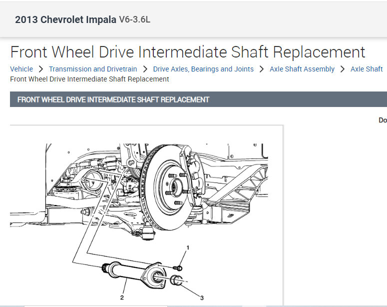

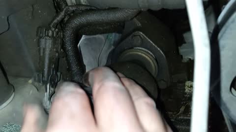

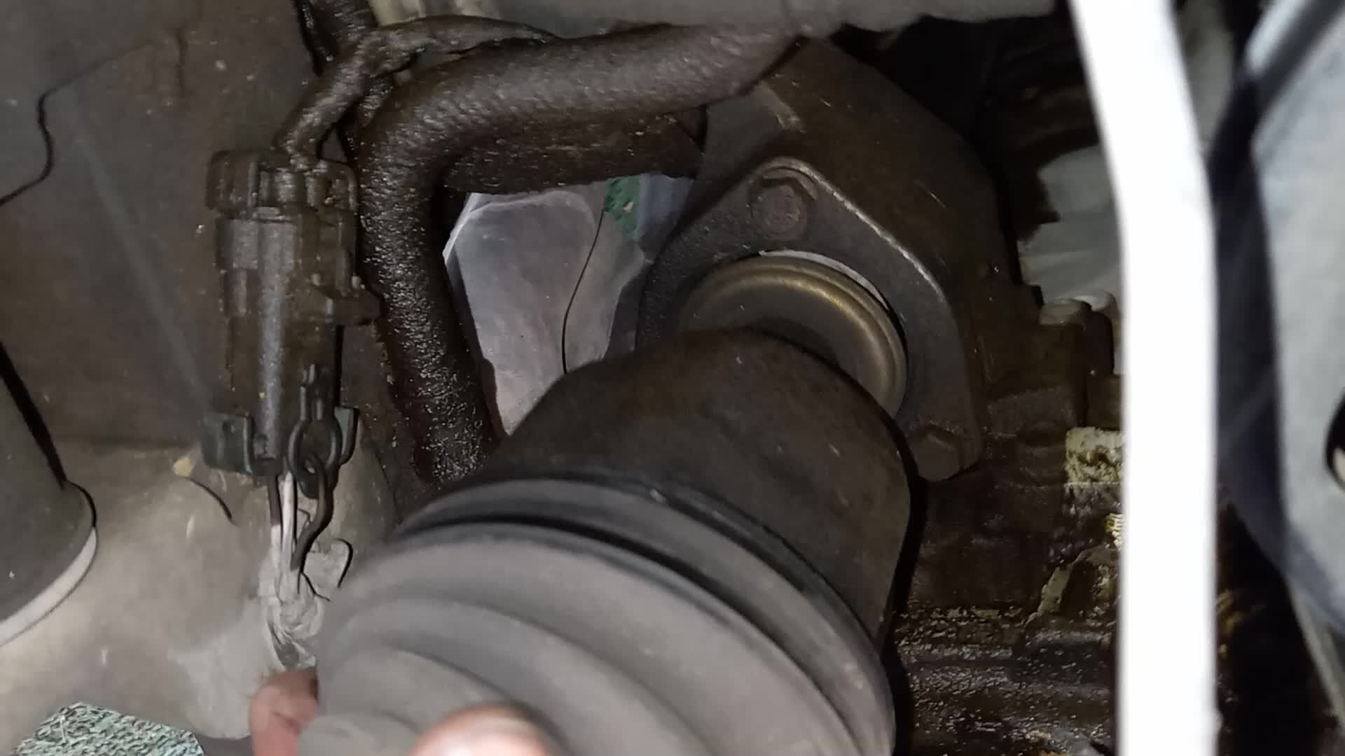

Have been hearing a clunk when turning wheels hard especially backing up. I've checked CV joint/axle with no luck. Today doing brakes I found this having out of its spot.
Jun 8, 2024 at 5:33 AM
  • 110,248 POSTS
Where is that located? I ask because it appears to be a bearing issue and not the actual CV joint.

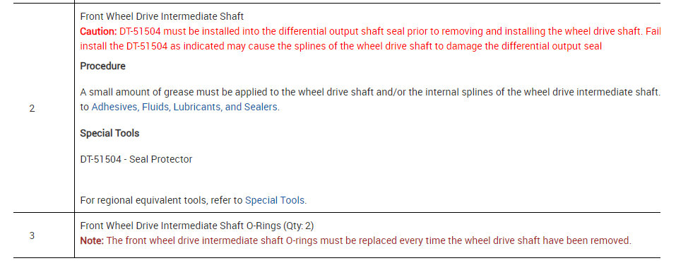

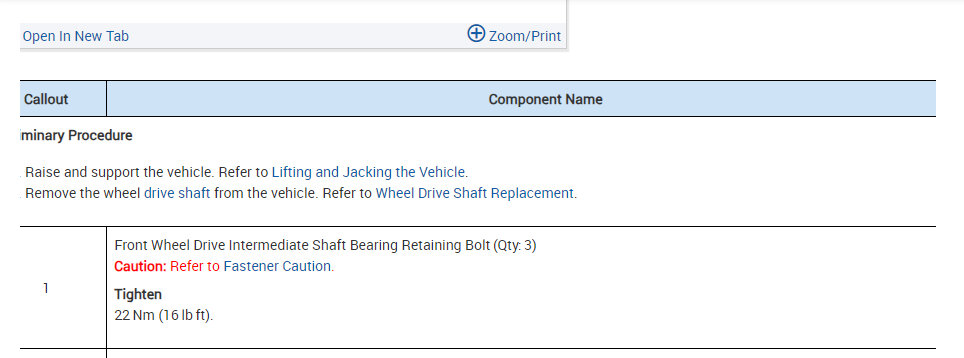

If I'm correct, this has an intermediate shaft bearing and that is what appears to have failed. I added the directions below for replacing it. Check this first.

Sorry I missed this email. That is going into wheel hub housing front driver wheel.

Okay, so, I see it says replace front wheel drive shaft orings any time shaft is removed. When I replaced the wheel hub assembly would I have needed to replace those rings?

As long as nothing gets damaged, you should be fine to reuse them. How far as you at this point? If you send me some pictures of what you are doing, it may help me to direct you better.
