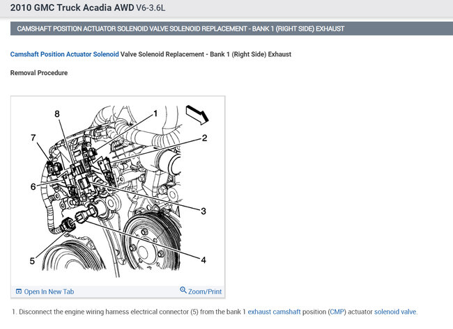

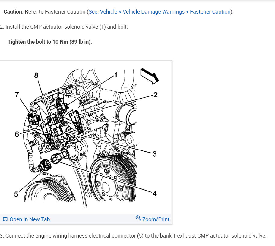

The circuit for the solenoids is a simple circuit The solenoid only opens to allow oil pressure in. When it closed it dumps the back pressure from the phaser, to the crank case.
That is the way I understand this circuit to work. The valve only pressurizes the phaser to advance the timing. There is not a return or opposing circuit. Cam rotation returns the phaser to the locked position after the oil pressure is vented. Did I miss something.

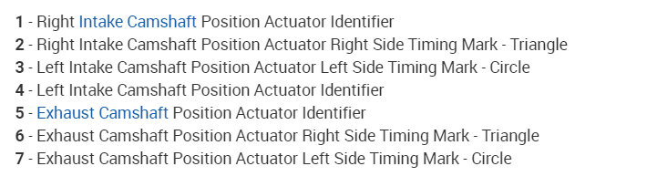

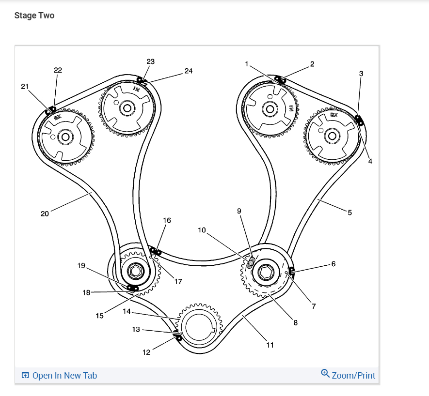

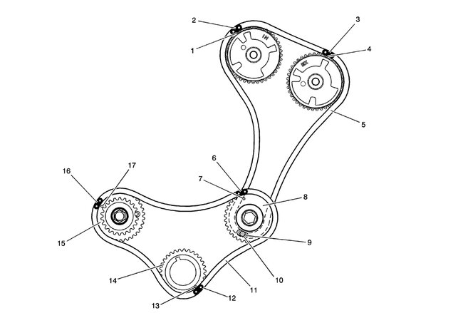

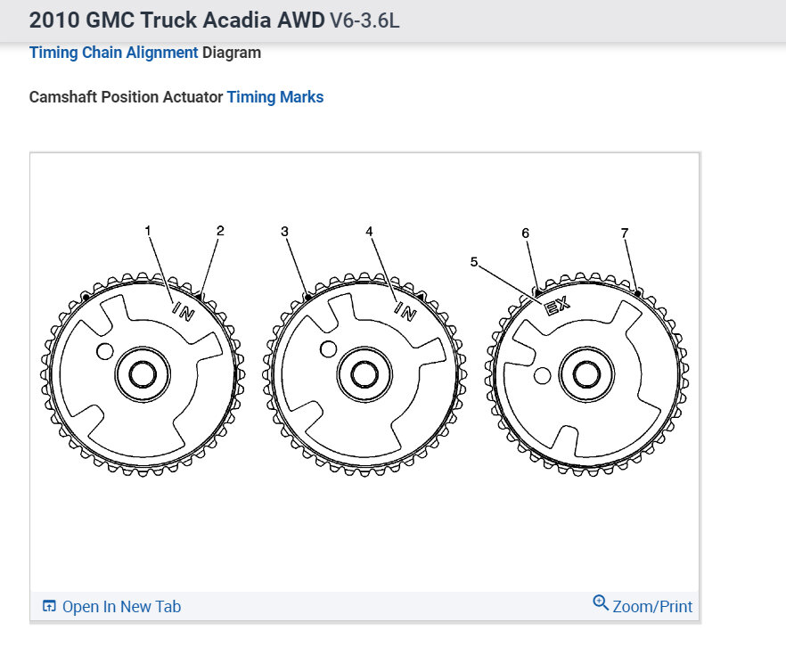

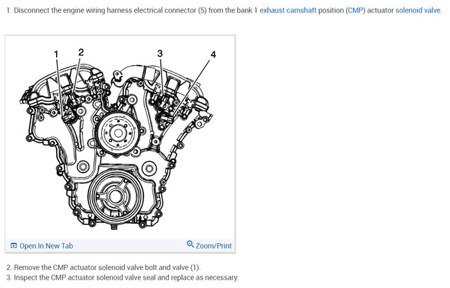

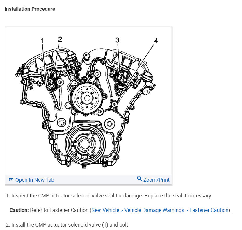

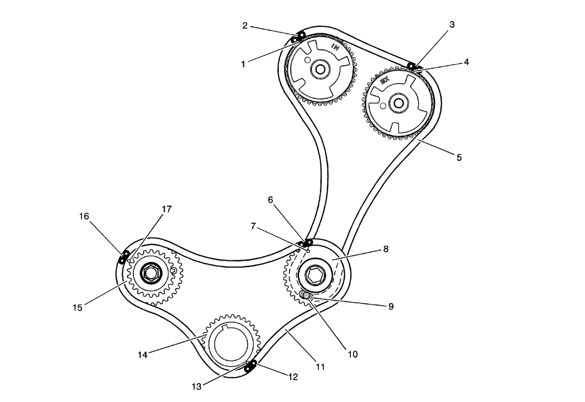

Also, "the cam phasers are not returning to their locked position" is the reason I suggested the camshaft oil control valve might be ticking open allowing oil pressure to keep the phaser activated. I cannot see the engine or check things myself so there is a slight disconnect over the internet, I apologize if I upset you in anyway. So, let's get this vehicle fixed. :)
The fact that the problem of the P0017 stands for “Camshaft Position B – Camshaft Position Correlation (Bank 1) problem, so the crankshaft is not aligned with the camshaft B. is there a chance the timing marks are just off a tooth?
The actuator returns to the neutral or standard position when the oil control valve exhausts the oil inside the phaser. Here is guide that shows how it works to help and I have included the timing marks for the chains and camshaft phasers to help you double check your work.
https://www.2carpros.com/articles/how-camshaft-variable-valve-timing-works
The marks are correct then something must have come apart or got stuck in the phaser not allowing it to return fully. Check out the images (below). Please let us know what you find. No worries about the frustration, no one is happy when they are having car repair troubles.

When I had the opportunity and had some access to the oil pan. I made efforts to clean out the oil pan both times I had access.
I am familiar with many of these illustrations. When I researched this project. I looked a multiply sources and did not just trust one single source. I used a GM tutorial that was posted on YouTube. I followed that sequence very closely, noting and identifying each unique alignment mark and position. After taking this apart a second time to install the new cam phasers. I made no mistake and triple checked my work. It is impossible for the cams to be out of alignment when this procedure is followed correctly. There are flats on each cam that need to be in position when the chains and timing marks are aligned. The phaser comes locked and cannot be moved without oil pressure.
You stated, "The actuator returns to the neutral or standard position when the oil control valve exhausts the oil inside the phaser". You suggested that there could be something inside the phaser that is preventing it from returning. Yes, that is a possible, but not probable This seems highly unlikely for the new phasers to suffer the same problem as the old phasers suffered. Remember, I mentioned that the old phasers were not returning to the locked position either. But when I removed the old phaser, it returned to the locked position when I was removing it. The old phaser was not being prevented from returning home due to any foreign object. It was oil pressure, and that pressure is always commanded. The phaser was advanced when the engine was shut off.
After all the considerations, I conclude that the cams are being commanded to stay advanced.
