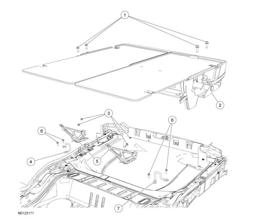

I have no use for third row seats. Can I remove them? do I need to install the cross brace as found on police versions?
Oct 4, 2017 at 12:22 AM
  • 55,433 POSTS
Yes you can remove them as far as the brace goes I have not seen one, but I believe it would have something to do with helping the structural integrity of the car something you might not need.
Below are some diagrams I found that can you you get the job done.

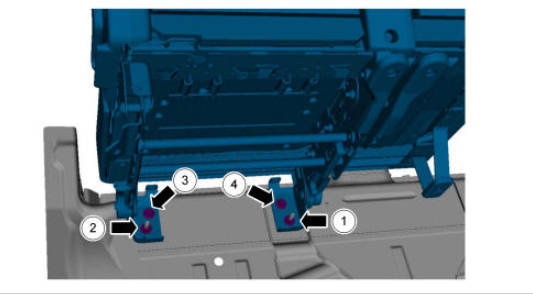

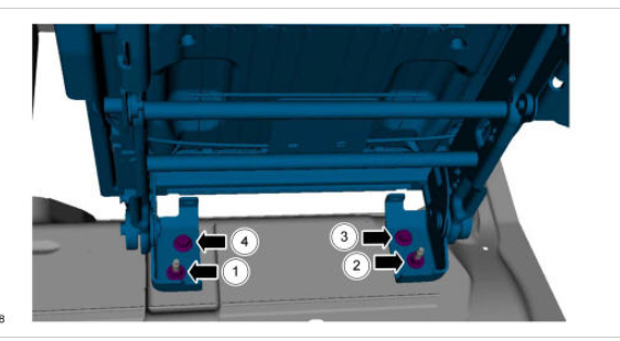

Does anybody know how to remove the third row seats in the vehicle listed above? I need to put down sound deadner and have no Idea how to go about doing this. Any help would be greatly appreciated.
Aug 25, 2020 at 5:56 AM (Merged)
  • 110,244 POSTS

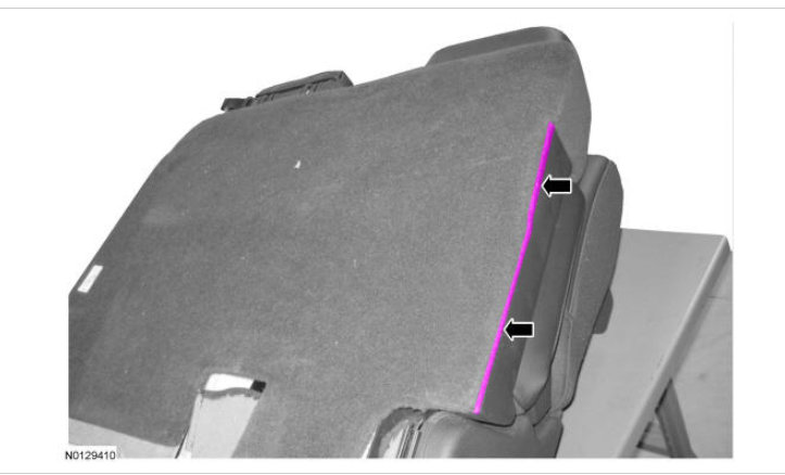

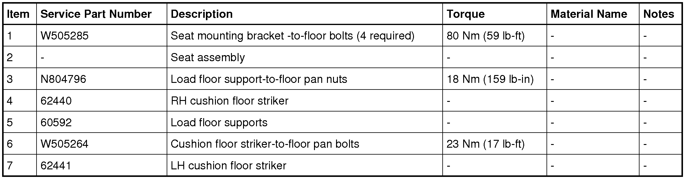

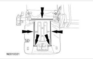

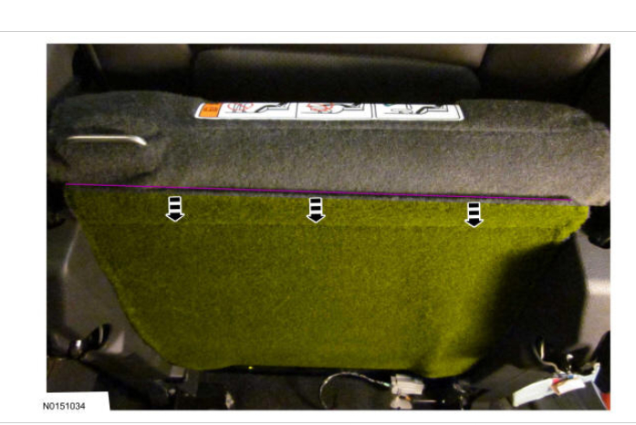

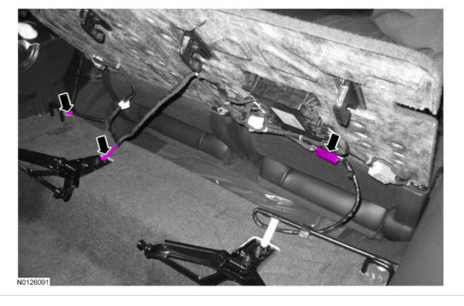

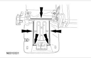

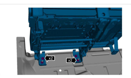

Here are the directions for seat removal. The attached pictures correlate with these directions.
_______________________________________
Seat
Exploded View
NOTE: Manual seat shown, power similar.
see picture 1
see picture 2
Removal
1. Remove the LH and RH quarter trim panels. REFER to Trim Panel, Quarter Trim Panel - Without Inflatable Safety Belts or REFER to Trim Panel, Quarter Trim Panel - With Inflatable Safety Belts .

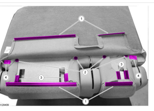

3. NOTE: If equipped with inoperative power seat, Refer to Manual Override of Inoperative Power Seat- 3rd Row See: Seats > Procedures > Manual Override of Inoperative Power Seat - 3rd Row.

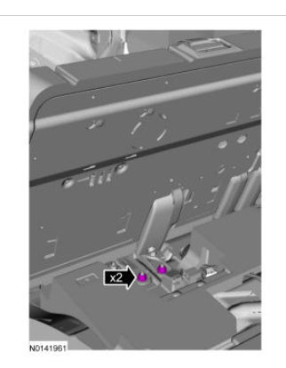

Position both seats to the load floor position.

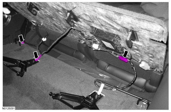

4. NOTICE: If equipped with a power seat, do not lift the load floor flapper panels too far or damage to the wire harness retainers will occur.
Separate the 2 load floor supports (1 shown).
- Push the load floor support rearward and slightly lift the load floor to disengage.
see picture 3

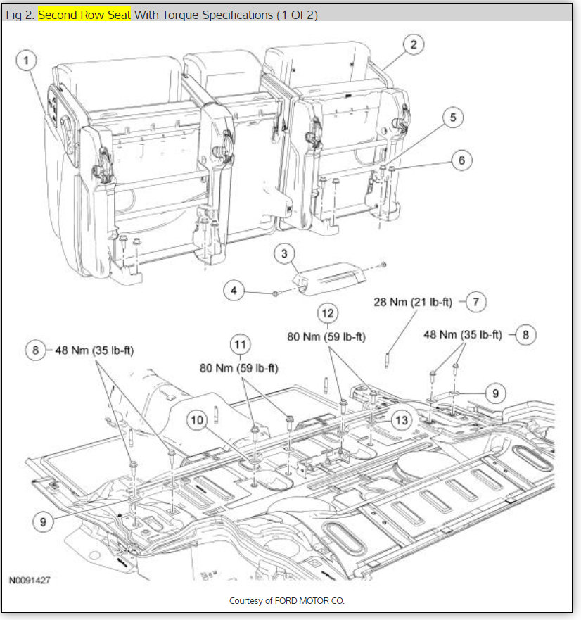

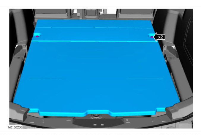

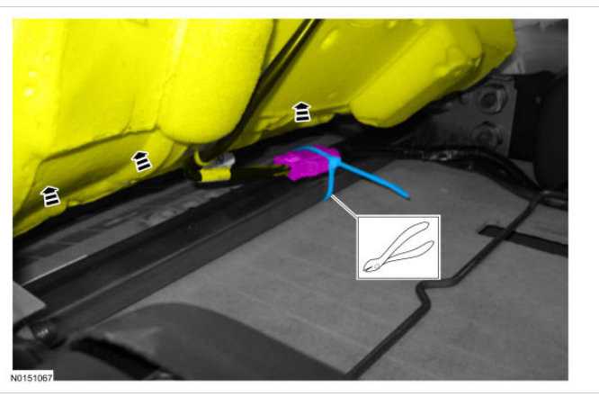

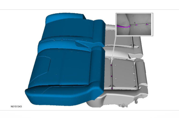

5. If equipped, disconnect the electrical connector and detach the wire harness retainers.
see picture 4

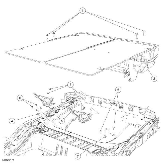

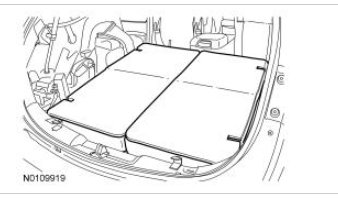

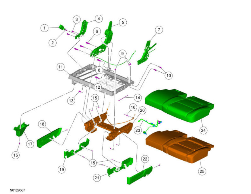

6. Detach the 2 wire harness retainers on the RH side.
see picture 5

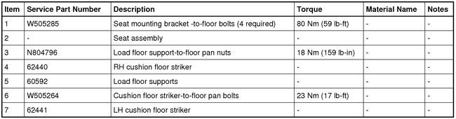

7. Remove the four mounting bracket-to-floor bolts and remove the third row seat.
Installation
1. Install the third row seat and the 4 mounting bracket-to-floor bolts.
- Tighten to 80 Nm (59 lb-ft).
