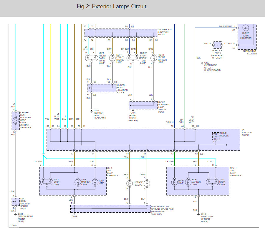

third brake light stays on when lights are on gets brighter when brake pedal is pressed it looks like one of the bulbs is burned on the third light had to reconnect the wiring to the trunk light and license plate lights last bulb changed was the front tail light noticed the problem with the third light after i had my front brakes changed checked the brake pedal switch.

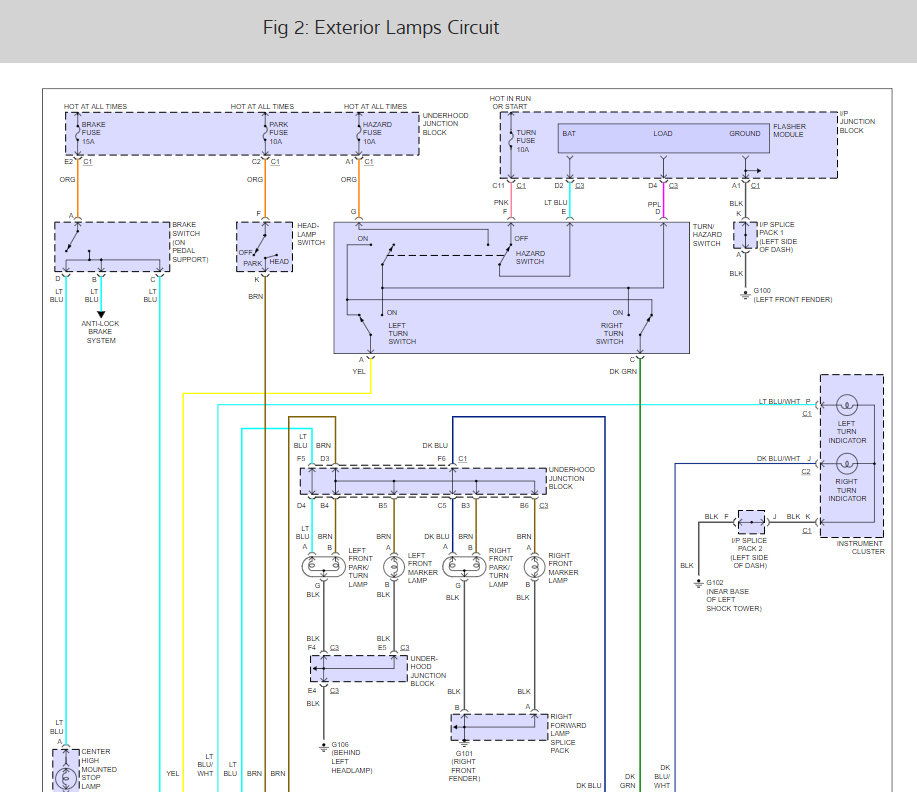

This sounds like the ABS control module is back feeding the third brake light here is a wiring diagrams so you can see how it works and a video of a ABS module getting changed out.

Thanks for this post I got a new module for $134.00 and installed it all fixed! I love this site.

my 3rd break light, when my lights where on & the emergency break applied, the 3rd light came on, take off the emergency break & it worked like it suppose to. also when i would apply the breaks the dashlight & radio lights got brighter, it happens everytime i step on the breaks.
now the 3rd breaklight comes on when i turn on my lights and stays on, when i apply the breaks the 3rd break light gets brighter. all the other break lights are working fine.

Hi verifone,
Thank you for the donation.
You have a ground circuit issue here. Check the rear taillights ground circuit connections for looseness, contaminations or corrosions.
Grounding points are at left rear body, behind left taillamp and on left and right side of rear shelf, 3 locations.
