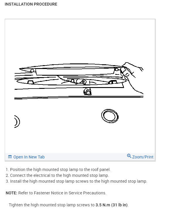

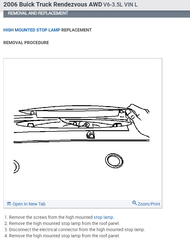

The third brake light is a complete unit with built in LEDs.
When it goes out the whole unit needs to be replaced.
It can be removed by simply taking off those two screws and it will pull out.
I have attached the replacement procedure below.
