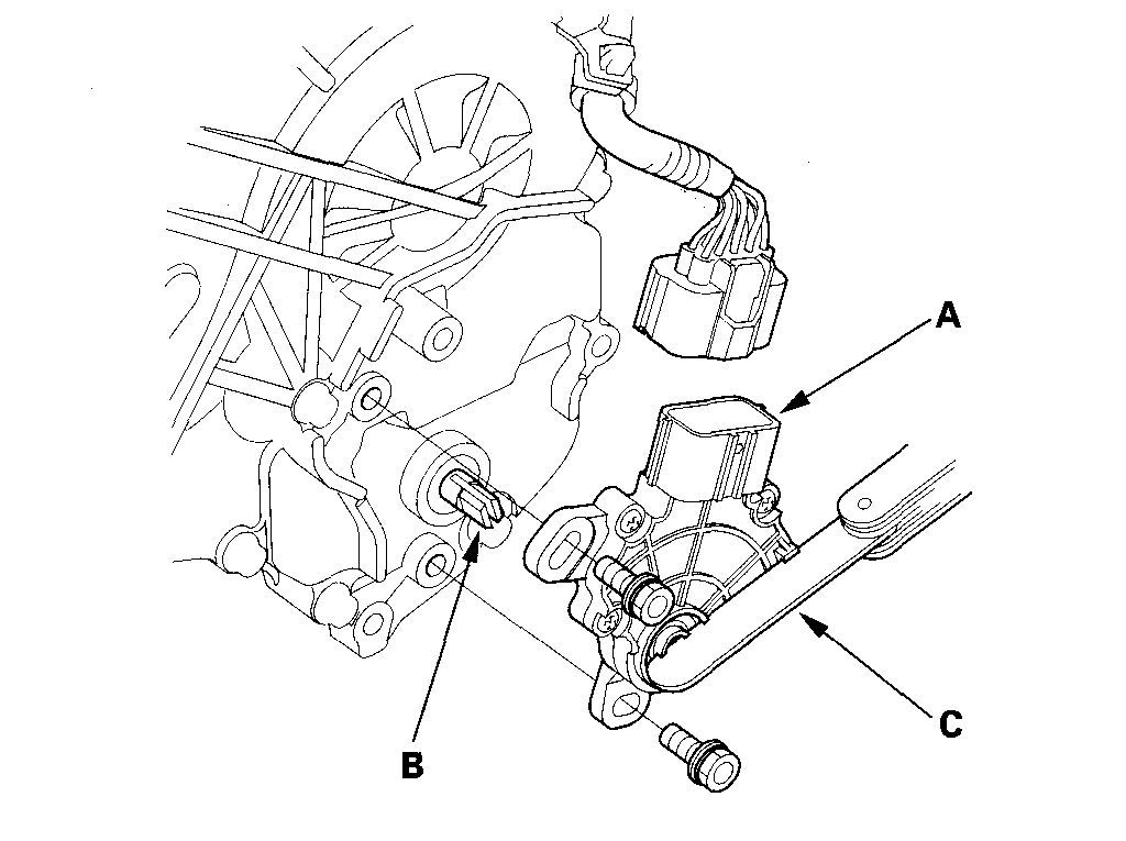

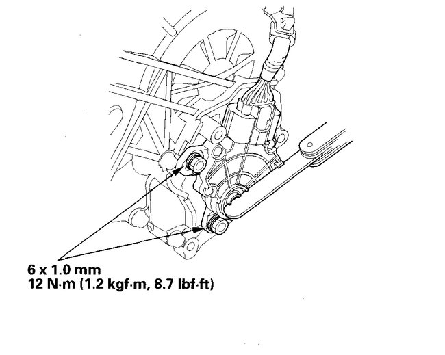

The car has been doing this thing where when you turn the ignition the car doesn't try to turn over but the dash lights up. It also won't let me remove the key after trying to turn it on. The dash indicates that the car is in Drive instead of Park, even though the shifter is in park. We had to disconnect the battery to get the key out. I tried using a screwdriver in the gear lock slot so I could move the gear shift, but it doesn't change that the car thinks its in drive. When I moved it off of park the car did start rolling forward though. Does anyone have an idea why this might be happening?

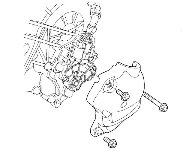

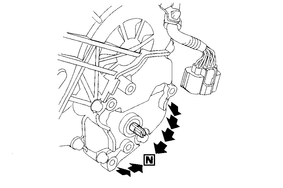

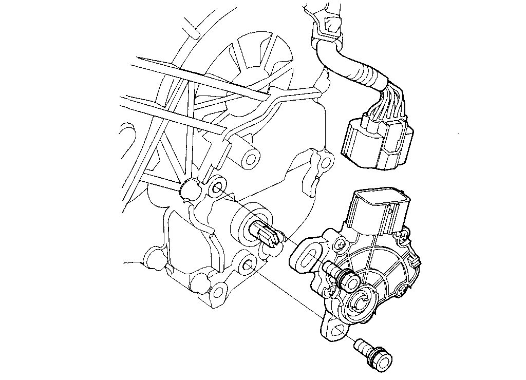

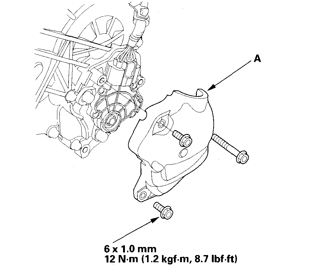

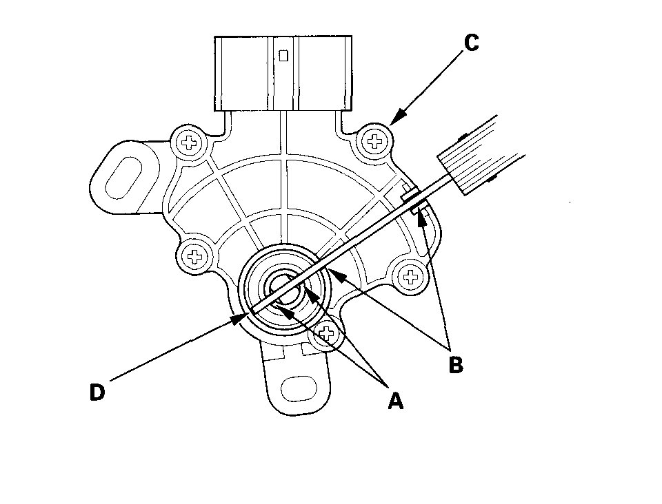

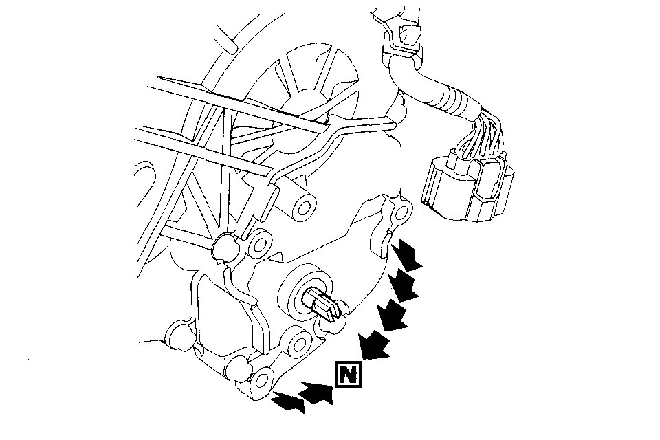

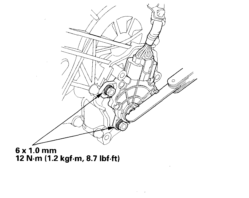

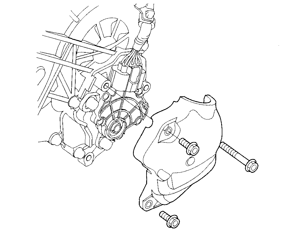

If the shifter is actually changing it from park, then I suspect the transmission range sensor is bad. It is mounted on the transmission and is what signals the computer for the light indication. First, check it to make sure it isn't disconnected or loose. If you find it needs replaced, here are the directions. The attached pictures correlate with the directions.

2. Shift to the N position.
pic 1
3. Remove the transmission range switch cover.
pic 2
4. Disconnect the transmission range switch connector.
5. Remove the transmission range switch, and replace the new switch.
pic 3
6. Make sure the selector control shaft is in the N position. If necessary, move the shift lever to the N position.
NOTE: Do not use the selector control shaft to adjust the shift position. If the selector control shaft tips are squeezed together it will cause a faulty signal or position due to play between the selector control shaft and the switch.
pic 4
7. Align the cutouts (A) on the rotary-frame with the neutral positioning cutouts (B) on the transmission range switch (C), then put a 2.0 mm (0.08 inch) feeler gauge blade (D) in the cutouts to hold the switch in the N position.
NOTE: Be sure to use a 2.0 mm (0.08 inch) blade or equivalent to hold the switch in the N position.
pic 5
8. Install the transmission range switch (A) gently on the selector control shaft (B) with holding it in the N position with the 2.0 mm (0.08 inch) blade (C).
pic 6
9. Tighten the bolts on the transmission range switch while you continue to hold the N position. Do not move the transmission range switch when tightening the bolts. Remove the feeler gauge.
