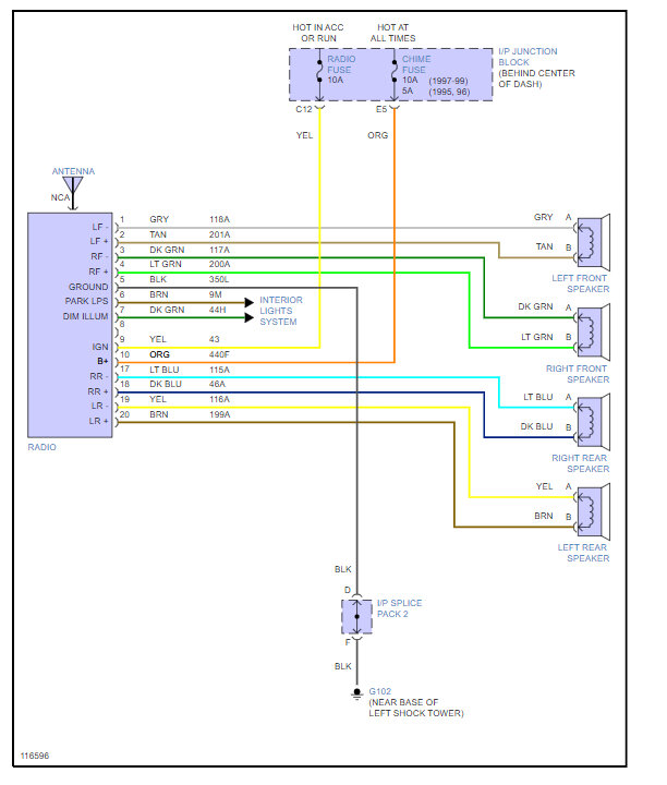

There's wiring hanging at my feet, wet outside, I didn't pay attention and pulled the already been yanked on loose cord wiring loose. I didn't wire the thing someone else did, so not sure where to hook it, it says another twelve volts but not sure what to do. I tried wiring to my radio it's on all time that's on the radio all time didn't work. The car was given to me two weeks ago and a lot of other wiring messed with. Neutral safety switch?

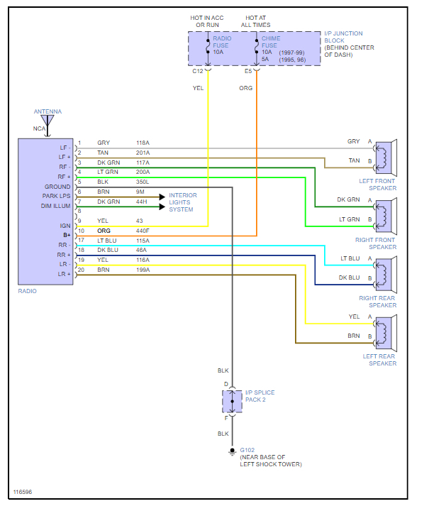

The neutral safety switch is at the transmission so you must be wiring the radio. If you upload an image of the wiring I can tell for sure. Here are the radio wiring diagrams to see if any match the wiring you are seeing?
