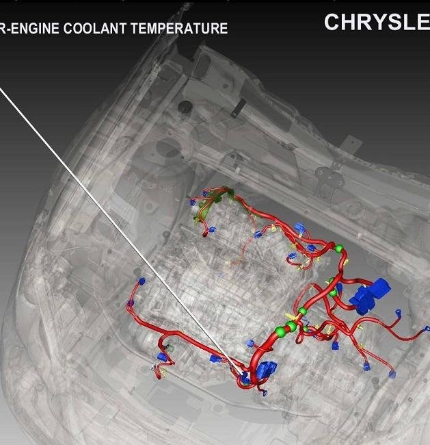

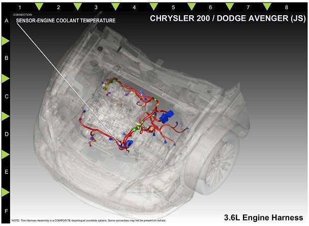

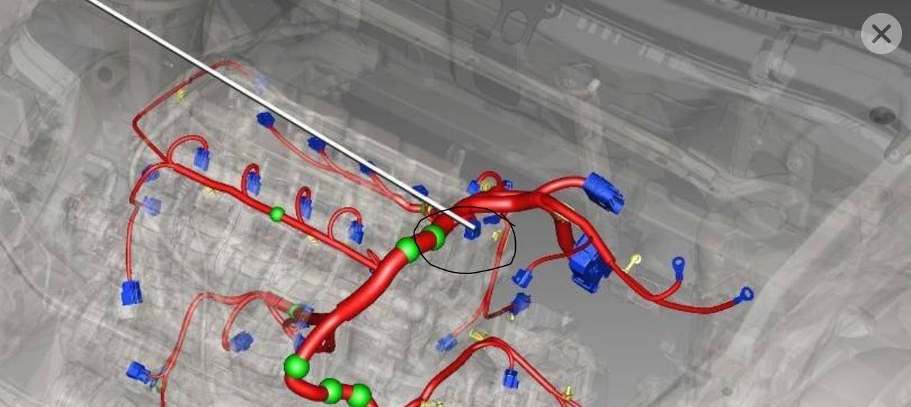

I am trying to locate the sensor to test it but not sure where it is located.
Sep 28, 2020 at 11:06 AM (Merged)
Good afternoon,
I attached the location of the sensor for you below. Check out the diagrams (Below). Please let us know if you need anything else to get the problem fixed.
