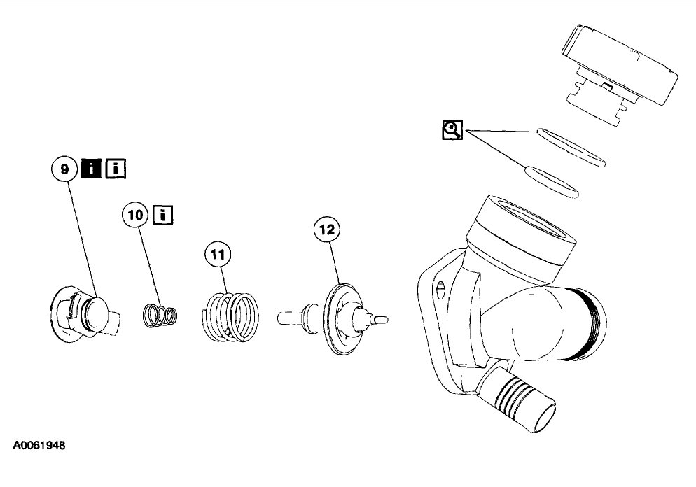

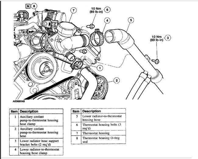

In addition to thermostat replacement, I also will be replacing the coolant part it mounts to. My question is: since there are other items close to the area, some wiring, hoses, etc., is it best to disconnect the battery first, and, when finished and battery re-attached will anything need to be re-programmed?
Aug 17, 2017 at 2:30 AM
  • 55,746 POSTS
Yes it is best to disconnect the battery and there should not be any reprogramming necessary.
Here are a couple of guides to help you get the job done:
https://www.2carpros.com/articles/how-to-replace-a-car-battery
and
Diagrams (Below) show you what its like on your car.
