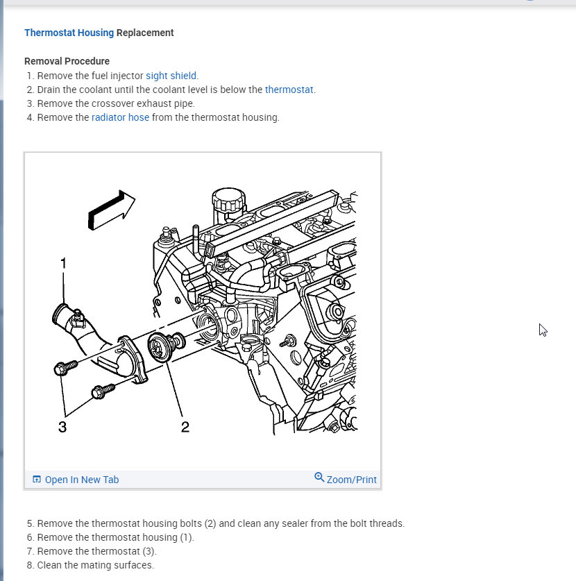

Where is the thermostat located on the vehicle
2003 CHEVROLET EQUINOX
145,000 MILES • AUTOMATIC
STEVIE OHLARIK
Where is the thermostat located on the vehicle listed above? Neighbor has issues with his vehicle showing engine as cold and fan staying on for 10+ minutes. Never replaced a thermostat on one of these.

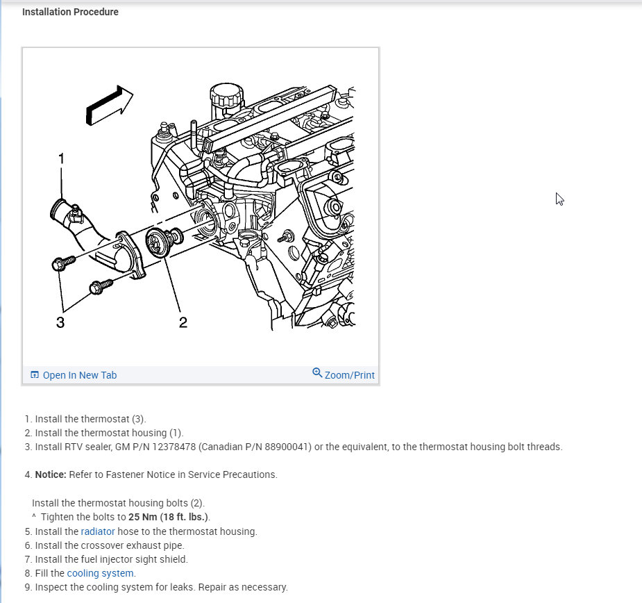

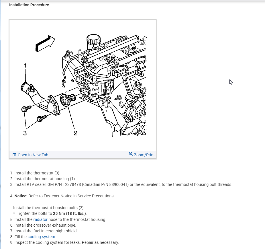

I am attaching the instructions for the repair. Let us know if you need more info. Check out the diagrams (Below). Please let us know if you need anything else to get the problem fixed. Thanks
