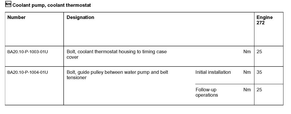

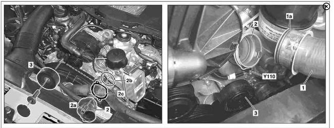

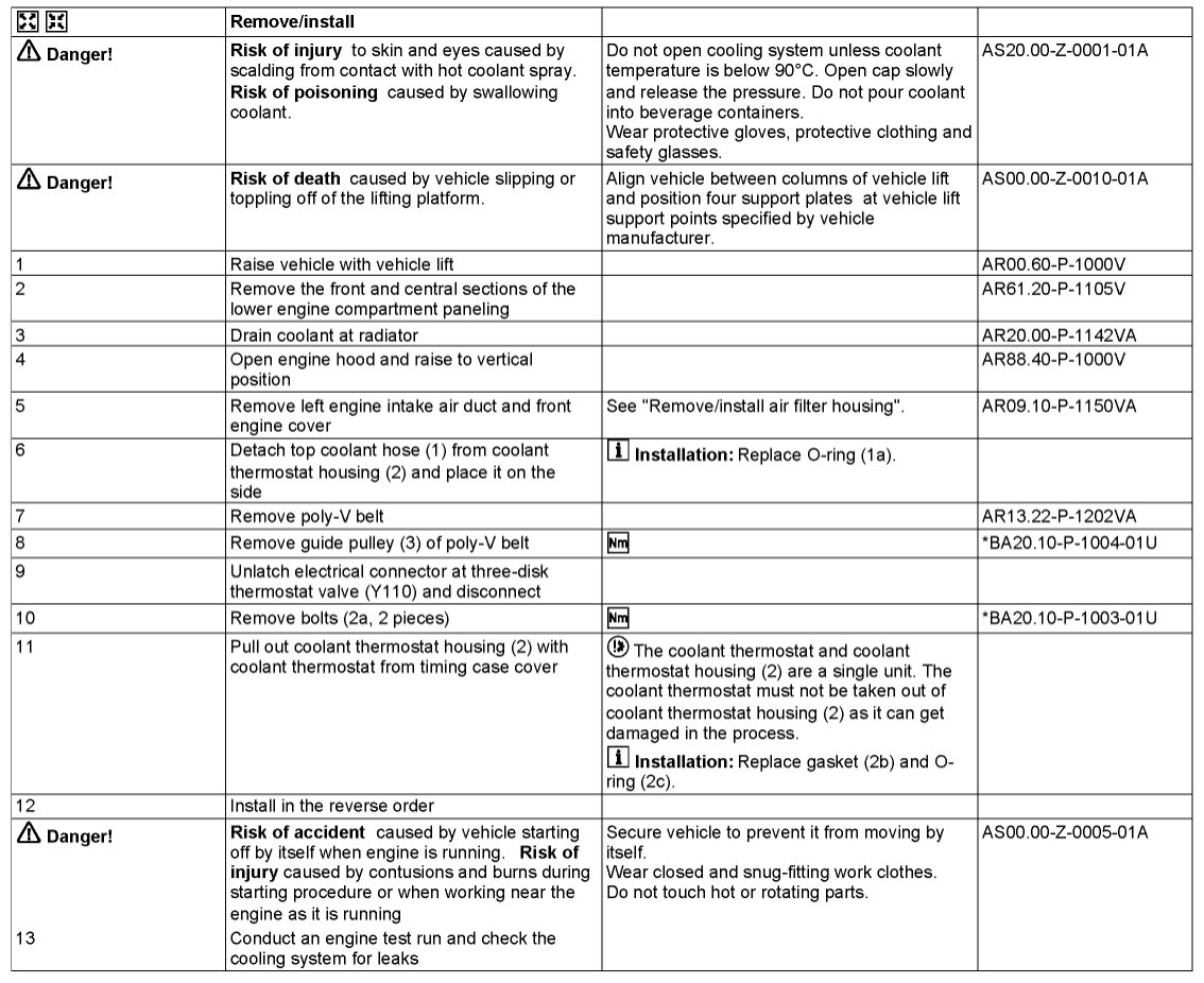

Appears radiator fan needs to be removed to gain access to thermostat?
Mar 16, 2017 at 12:51 AM
Experienced Mechanic
55,604 POSTS
Your must start by draining the coolant, here is a guide and some diagrams from the manual to help you get the job done.
Best, Ken
