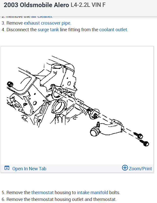

Can't find thermostat.
Apr 26, 2025 at 10:43 AM
Experienced Mechanic
55,636 POSTS
The thermostat is located at the rear of the engine on the intake manifold, here is the location in the images below. Check out the images (below). Please let us know what happens.
