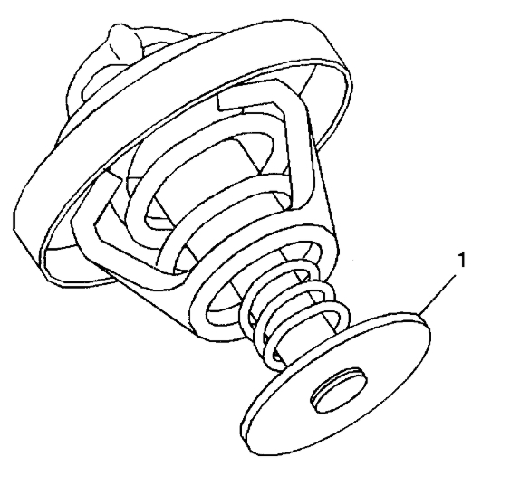

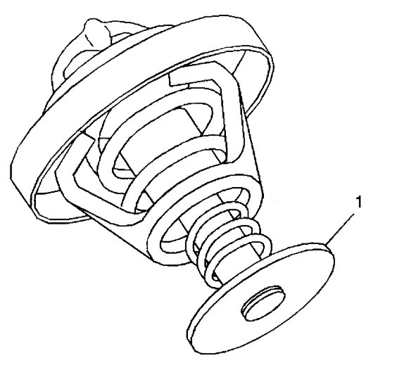

Which way does the thermostat go in?

Here is a tutorial for you to view showing thermostat replacement:
https://www.2carpros.com/articles/how-an-engine-thermostat-works
I've also attached a picture below.The bottom #1 should be inside the mounting area.Hope this helps and thanks for using 2CarPros.

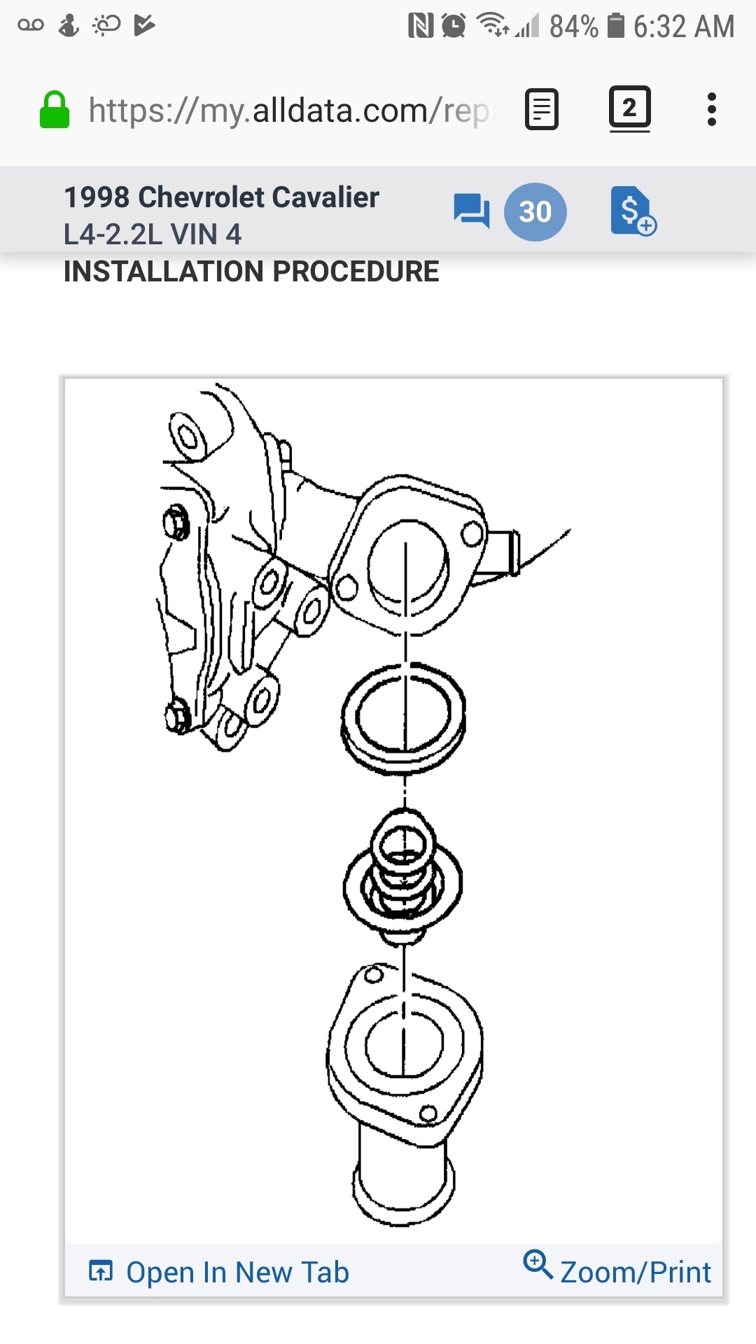

Thanks for answering, but this did not help. Can you show me other pictures?

Hello I'm Harry. Does this image help?
Image (Click to make bigger)
