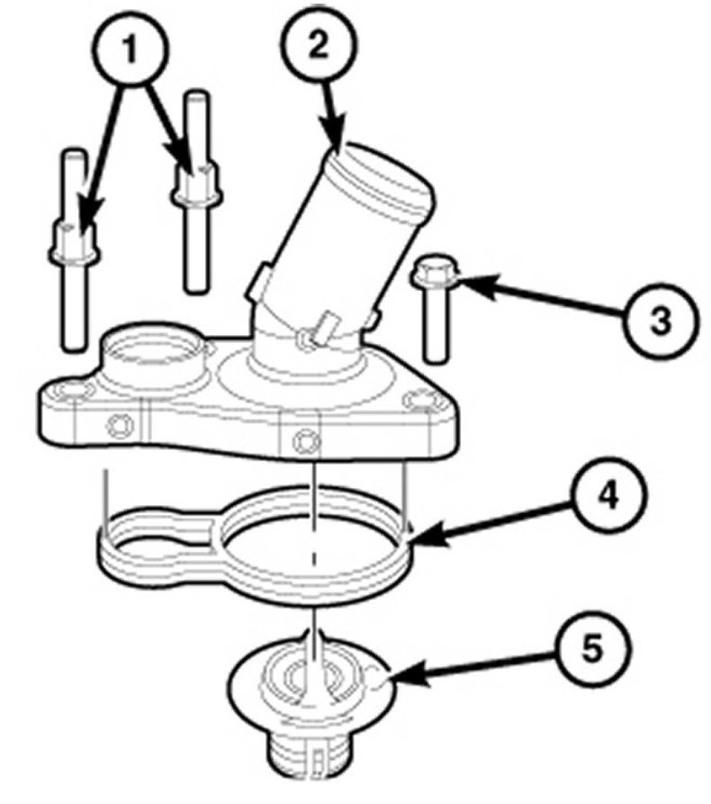

Hi, I am trying to find where the thermostat is located on my vehicle. I have Googled it and cannot find anything on it.

The 2.7 thermostat is located on the side of the block right above the A/C compressor. To get to it you need to remove the drive belt and then put the vehicle in the air and unbolt the compressor to move it out of the way to get to the thermostat housing bolts. With it out of the way you remove the housing and reverse the process to install the new one, make sure the purge valve is at the top.
