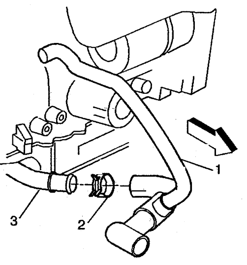

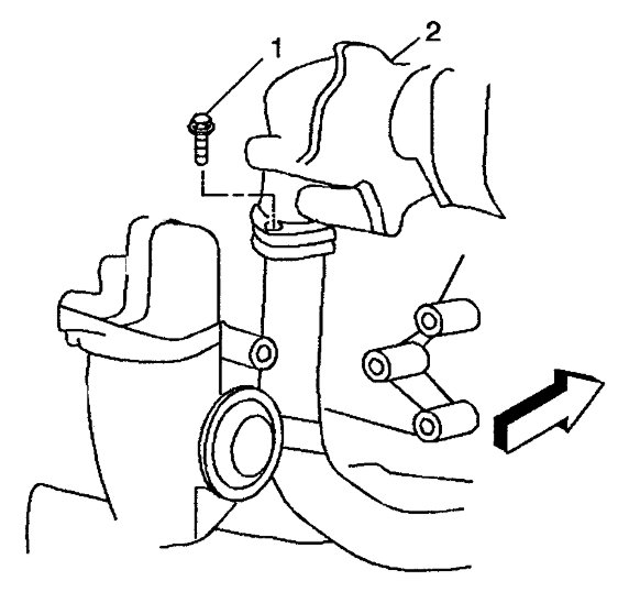

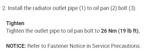

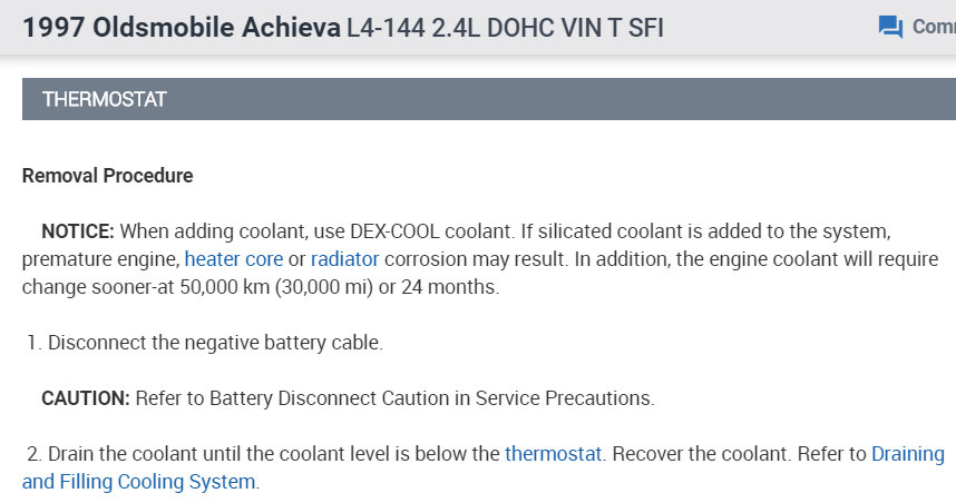

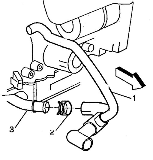

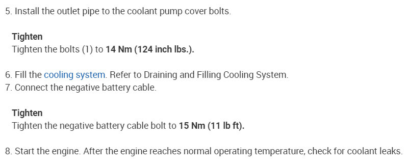

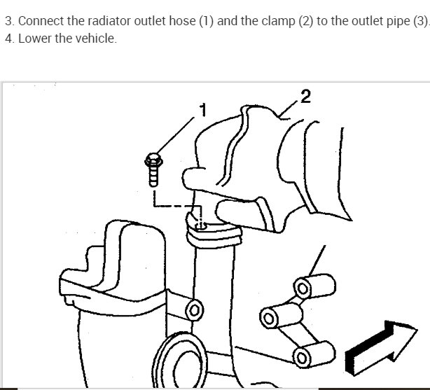

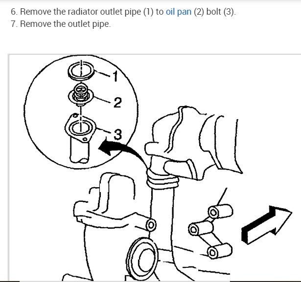

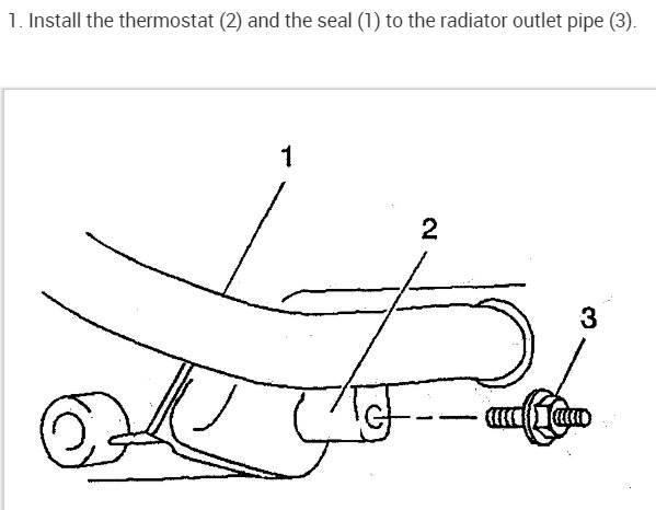

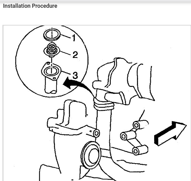

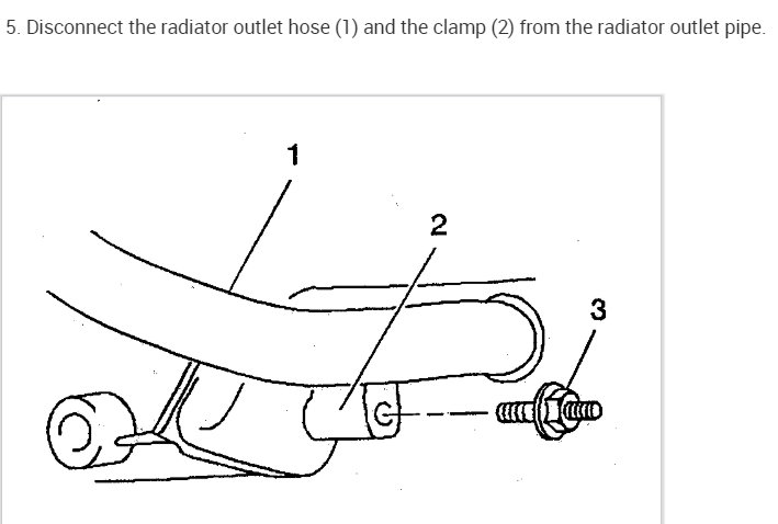

The coolant thermostat on my car listed above is not where the top radiator hose meets the block. Where is it and how do I remove and replace it?
Jun 5, 2020 at 5:24 AM
DANNY L
  • 5,648 POSTS
Hello, I'm Danny.
Here is a tutorial showing what is involved for replacing a thermostat:
I've attached picture instruction steps below for your replacing your thermostat on your car. Hope this helps and thanks for using 2CarPros.
